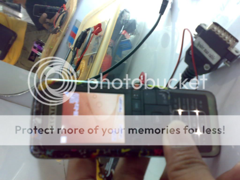

C820A ALCATEL LOGO nagawa na infinity by testpoint
BLIND
Dec 23, 2014
2,965
14
381
manila
PROCEDURE:
open infinity software
select model c820A ALCATEL
select com port
go to FFS CLICK CONNECT
if the phone ditect
click process
Code:
COM16 [VCP1] selected
module  v2.73
Action: reset settings
Model: Alcatel-C820A
Checking data, wait...
Phone should be Switched OFF !
Press and HOLD Power button now !
19200 autodetect
Initializing [6219:8B03:8B02]...
CPU: MT6219
chip: 0031:2D2B:A000
status: 01
detected CPU: MT6226MA
Connecting at 19200, wait...
Release Power button now !
Phone detected, wait...
Hardware: MT6226M,E03
Date: 2005.04.12
Version: 1.0
Version: MAUI.06A.W06.28.MP.V45
Version: JRD26_06A_HW
43 byte(s) read
imei: 00000000000000
connection Ok
building list...
done
items total: 260
items to clear: 260
warning: wrong packet cs
items cleared: 246 of 260
building list...
done
items remains: 2
Finished, time used: 102 sec
