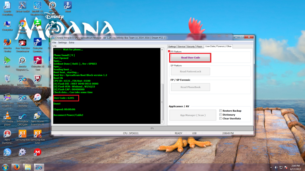

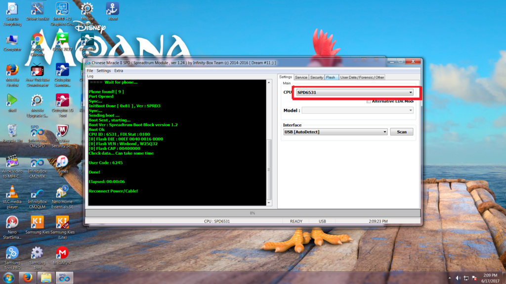

wandel Registered Joined Feb 22, 2016 Messages 35 Reaction score 0 Points 1 Jun 17, 2017 #1 share kolang po mga ka antgsm c8i password problem open lang po cm2 spd tapos read user code para maditect ng cm2 press * tapos salpak done napo sya tested many times no need to format sana po makatolong
