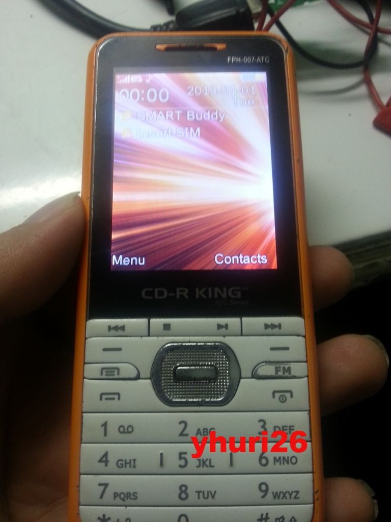

Share ko lang mga papa cd-r king-007-atc illegal use at namamatay
kapag may sim,

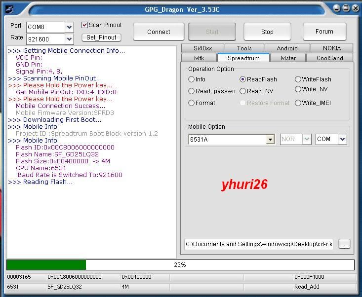

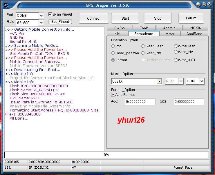

Action taken: connect box open GPG Dragon Ver: 3.53c
jigs P-12c or RX TX cable
choose 6531A Readflash muna then Format
