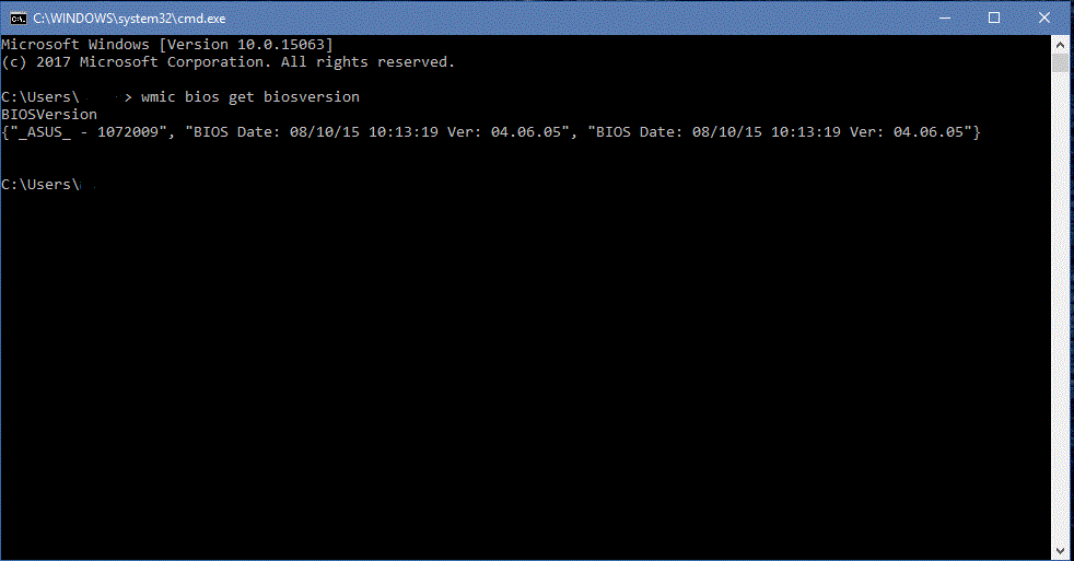

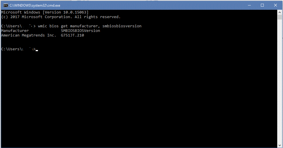

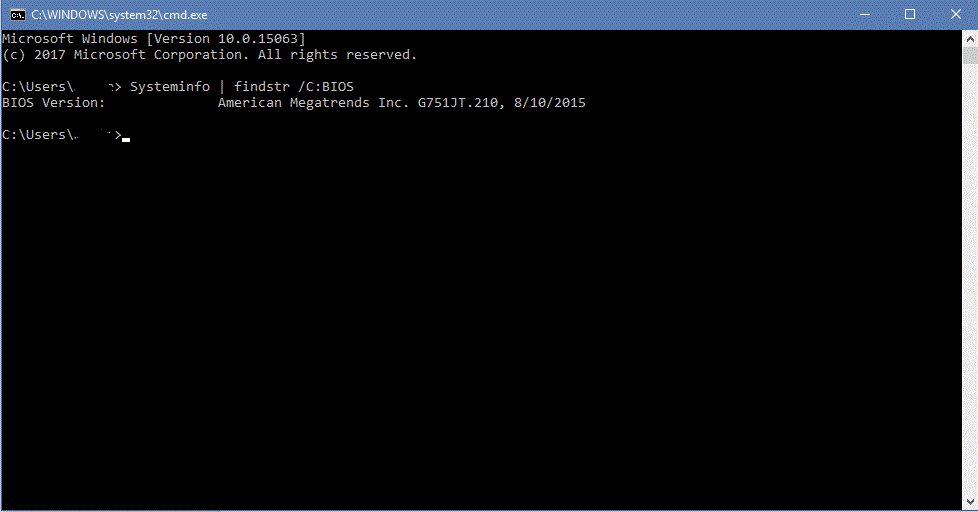

OPTION 1: Check BIOS or UEFI Firmware Version Using A Command Prompt:
1.
Press the Win+R keys to open Run, type cmd into Run, and click/tap on OK to open a Command Prompt
2.
Enter either command below you want into the command prompt,
(you can copy and paste it in to avoid typo's) and press Enter. (see screenshots below)
wmic bios get biosversion
wmic bios get manufacturer, smbiosbiosversion
Systeminfo | findstr /C:BIOS

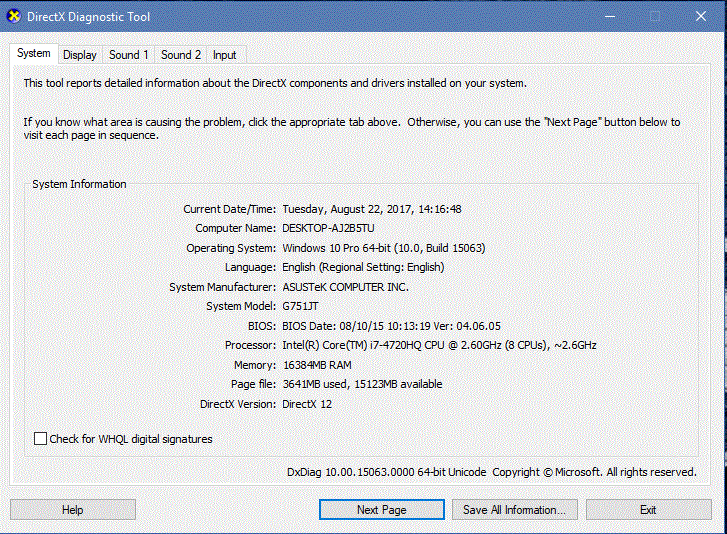

OPTION 2: Check BIOS or UEFI Firmware Version using the Directx Diagnostic Tool
1. Press the Win+R keys to open Run, type dxdiag into Run, and click/tap on OK to open the DirectX Diagnostic Tool.
2. In the System Tab, look at the BIOS line under System Information to see what your current version is. (see screenshot below)

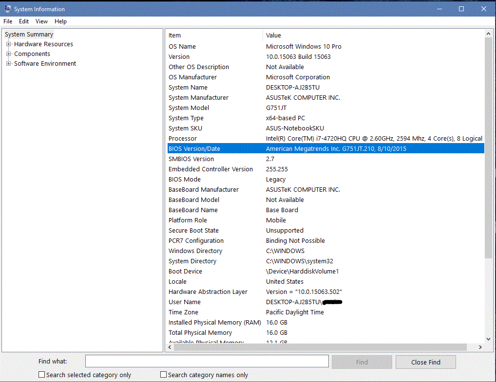

OPTION 3: Check BIOS or UEFI Firmware Version in System Information
1.
Press the Win+R keys to open Run, type msinfo32 into Run, and click/tap on OK to open System Information
2.
In the Right Pane of System Summary in System Information, see what the BIOS Version/Date shows for your version. (see screenshot below)
