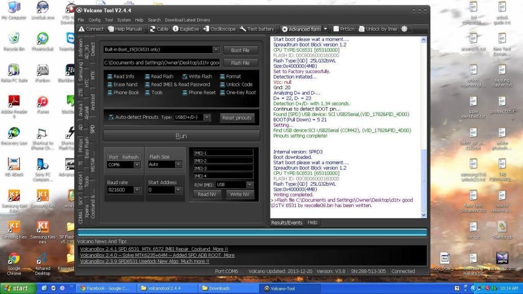

dead after format message failed lagi ang lumalabas at di makapag delete

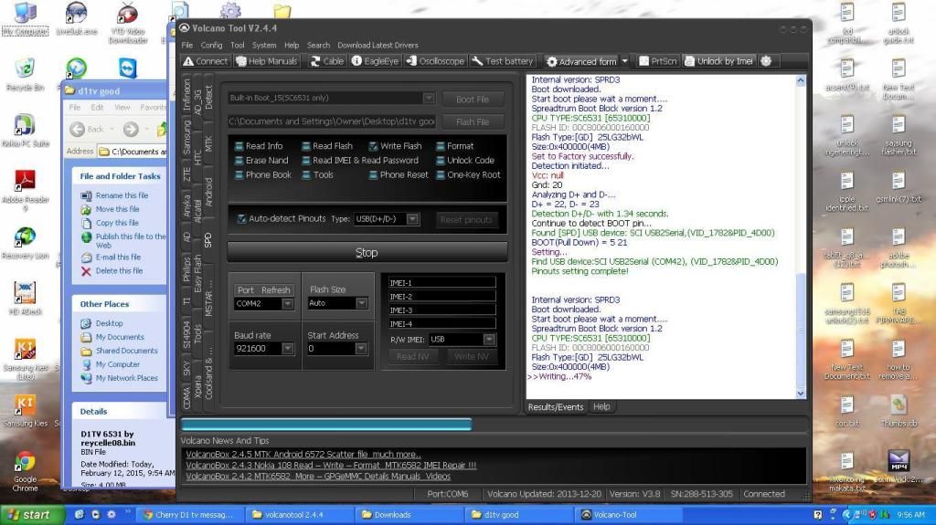

open ko volcano 2.4.4 readed nmn siya using usb p-05b pero pag format ko dead agad unit
buti may back up ako write buhay ulit bat same problem ang unit hanap muna sa forum at nakita ko tong back up ni boss jhong_thugs
heres the link
http://www.ant.ph/showthread.php?p=172332#post172332
ito naman ang firmware
http://www.4shared.com/file/D6BybteWce/D1TV_6531_by_reycelle08.html
done sa flashing salamat sana makatulong
