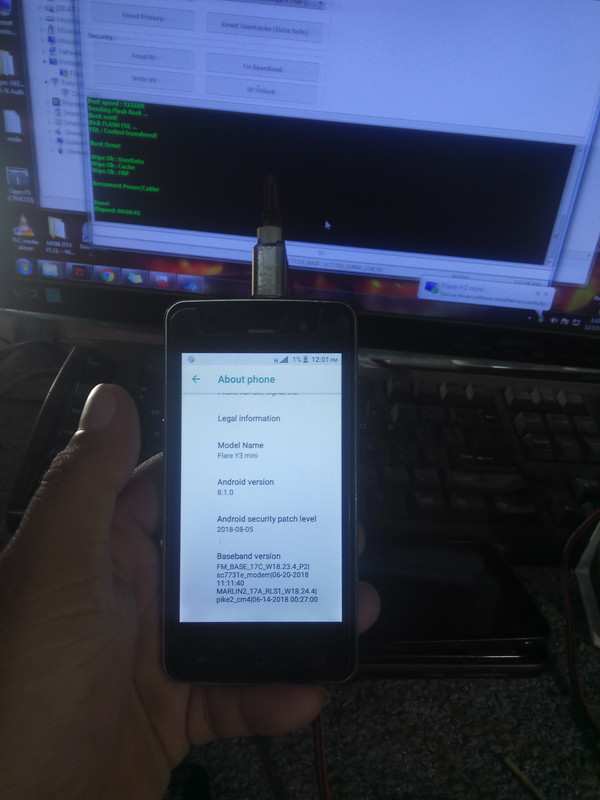

CHERRY FLARE Y3 MINI FRP

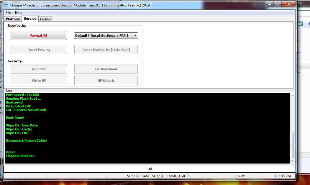

Infinity-Box AChinese Miracle II : SPD/USC Module [SP2] v2.01
Load IDBase v9215 Ok!
Operation : Format FS / Reset Settings [ v2.01 ]
Mode : Default [ Reset Settings + FRP ]
1. Power off device, wait 10-15 seconds
2. Press and hold BooKey ( 1 : BOTH VOL , 2 : VOL+ , 3 : VOL- )
3. Insert cable in device!
Wait for device ...
Device Connected!
BootVersion : SPRD3
Boot : INF : 0_SC7731E_BASE : SC7731E_eMMC_1GB_RS
Sending Init Boot ...
Boot sent!
Kick FDL ...
BootVersion : Spreadtrum Boot Block version 1.1
Protocol setup ...
Port speed : 921600
Sending Flash Boot ...
Boot sent!
Kick FLASH FDL ...
FDL : Control transfered!
Boot Done!
Wipe Ok : UserData
Wipe Ok : Cache
Wipe Ok : FRP
Reconnect Power/Cable!
SALAMAT SA PAG VIEW MGA IDOLS..FOR REFERENCE ONLY
