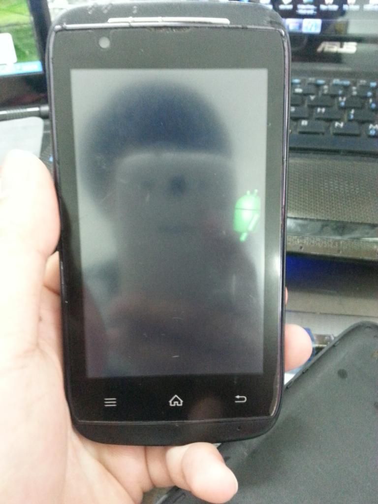

Problem: hang logo..

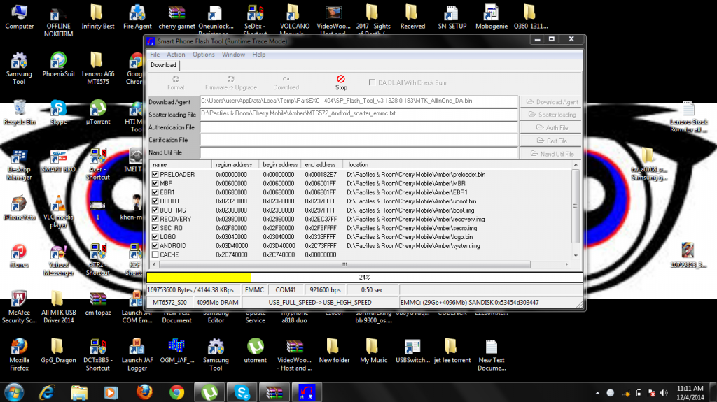

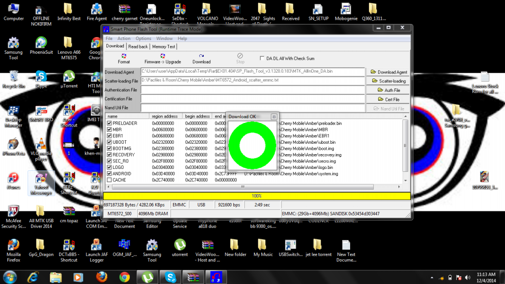

Procedure:
open sp flastool
load scaterfile and click download.
wait till finish.
screenshot..

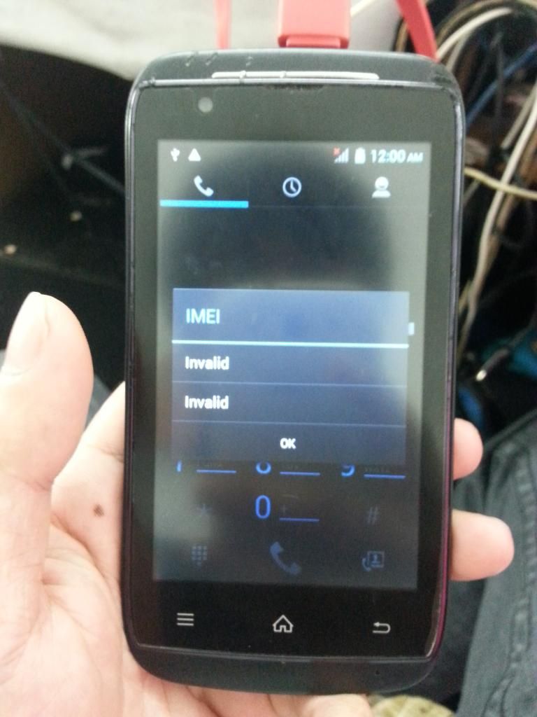

pagkatapos e flash hang logo parin.

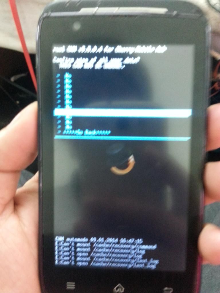

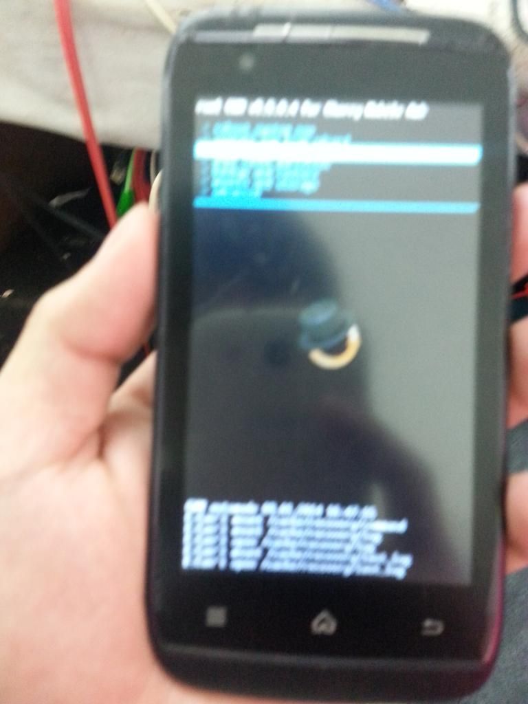

hard reset

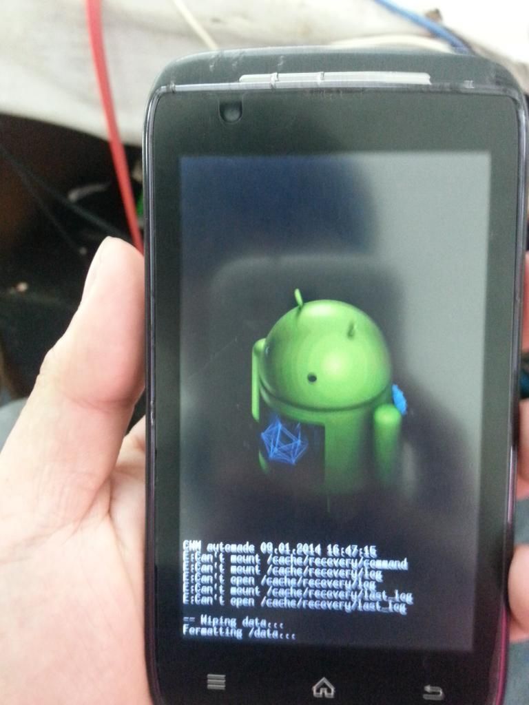

press vulume up antayin lumabas recovery mode.
scroll down hanapin ang wipe data.

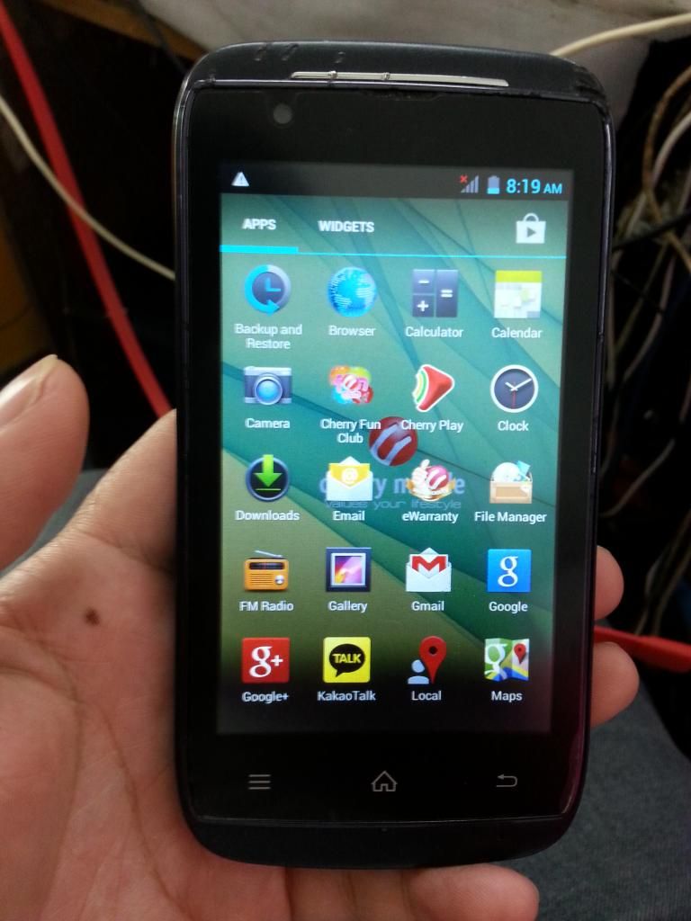

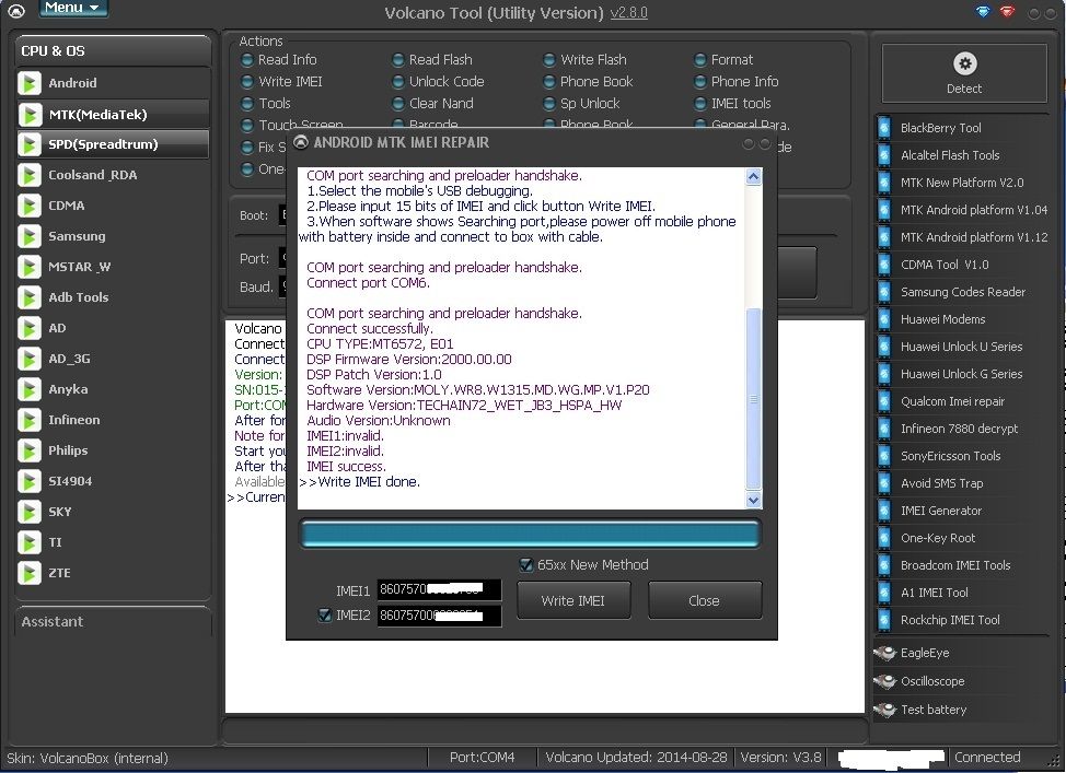

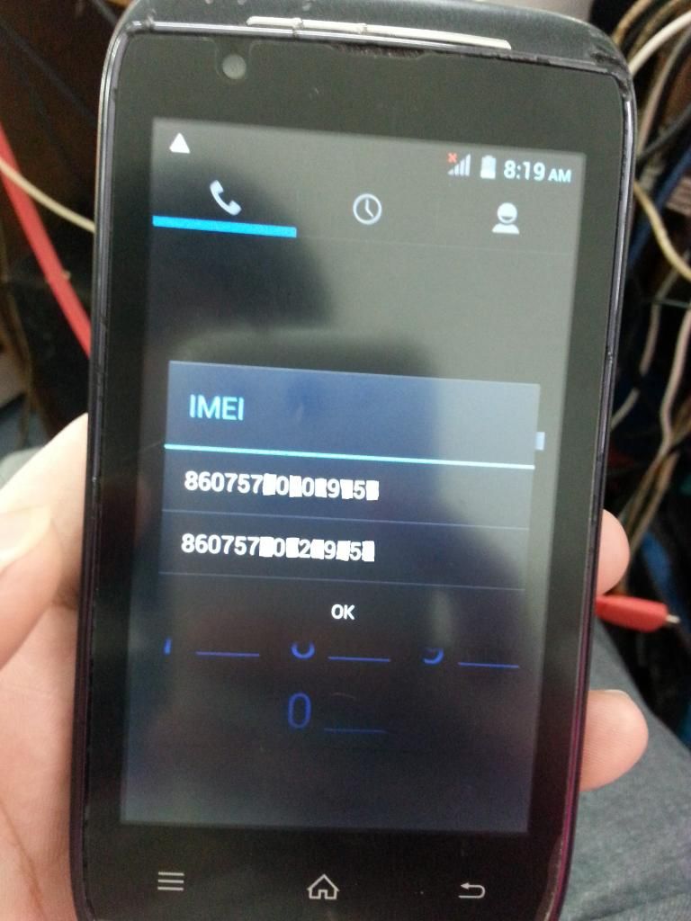

invalid imei
rebuild imei using volcano.
screenshot..
Solved.
