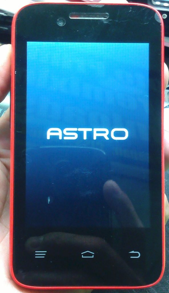

History->nagdownload lang daw ng apps ayon hang na.​
Try kona hard reset and format using box no luck.​
Kaya flashing na ang katapat.​

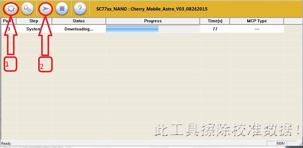

1st->open muna natin ang research downloader​
2nd->load ang pac file sundan lang ang pic sa baba wala na kayo babaguhin.​
3rd->Click play button and press vol-down hintayin lang hanggang matapos ang flashing [passed].
Hang in Astro

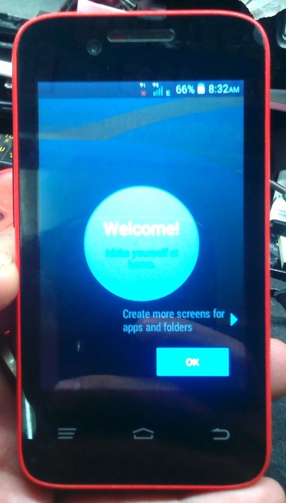

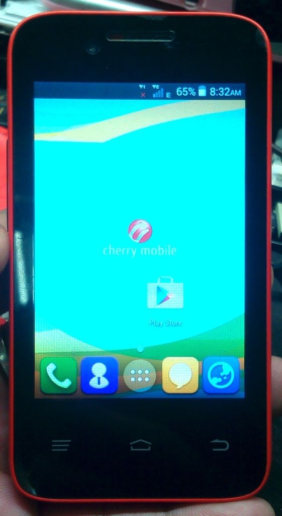

After flash done
Pac file and flasher->cherry-mobile-astro-SC7715.rar
Password->astroboy
nOTE. Ok lahat signal,camera front and back,wifi,and bluetooth.
credits: to orig uploader ng file thanks
