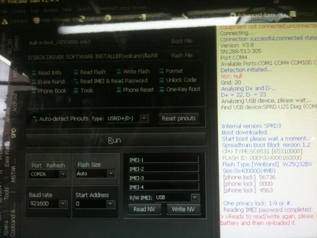

CHERRY MOBILE B8 PASSWORD NA PAHIRAPAN DONE
ALAM KO MARAMING NAG IINGAT SA UNIT NA TO
ITO LANG KATAPAT NIYAN SANA MAKATULONG
MODEL=B8
CPU=6531 SPD
PROBLEM PASSWORD
VOLCANO NA KAILANGAN V.2.4.4
1ST= READ FLASH PO MUNA TAYO PARA IWAS ABONO
2ND= READ IMEI AND PASSWORD
3RD= WAIT NATIN HANGGANG MA READ..ANG PASSWORD
NAKAHUBAD PO YAN KASI PAG FORMAT KO PATAY SA IBANG VERSION NG VOLCANO..MEDJO NATARANTA HAHAHA
AYAN NA ANG PASSWORD INILUHA NA..
WAG MAG ABONO MATUMAL :p
