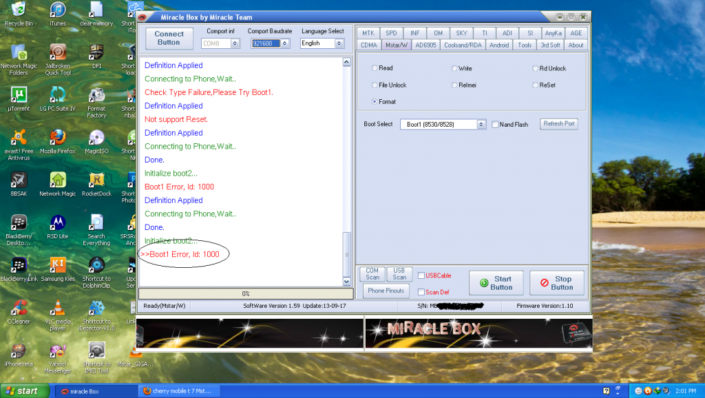

unit:cherry mobile beat t7
proble: Hang on logo
soution:
back ip ko muna para iwas dedo.. tapos
try ko ireformat pero laging error: (di daw kc supported sa format eh)
kaya next option ko eh flashing na...pero wala akong tested firmware..

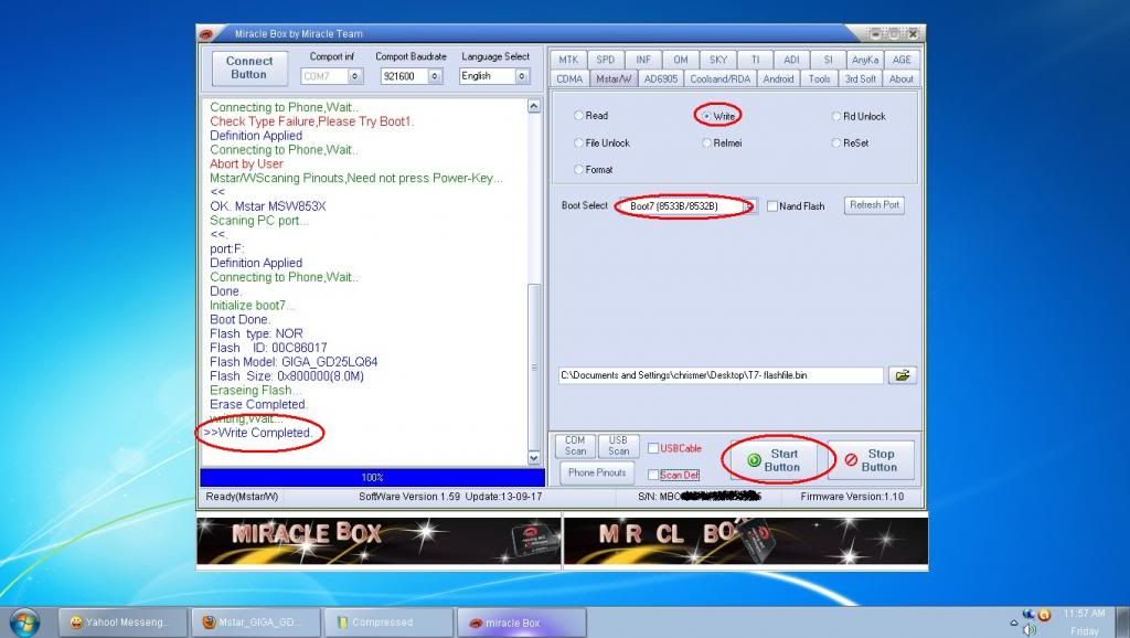

after 3 days.. my nag bigay din sa akin..... tnx boss jun....
eto po yung firmware
T7- flashfile
after ko ma download ...
flash ko agad.....
bute nalang one shot lang.....
after ko ma flash test ko agad ang unit at ok naman... working po lahat..
