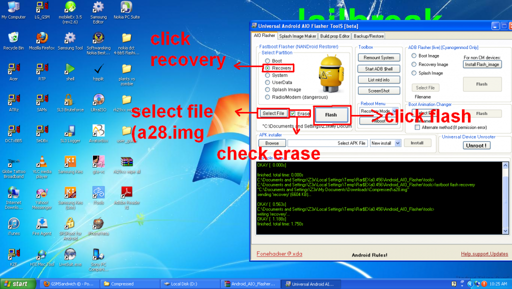

try this boss (a28.img) http://www.4shared.com/file/3JEecIKP/a28.html
(aio flasher)http://www.4shared.com/archive/ckLr52x3/Android_AIO_Flasher_140_by_Fon.html
(Rom)http://d-h.st/pFf
(net framework)http://www.4shared.com/zip/wrxjeZf6/Microsoft_NET_Framework_-_v403.html
instructions:
una install muna ang CWM kailangan idownload ang a28.img at android_aio_flasher para ma instal ang CWM.
pag na download muna,
open andriod flasher
press vol.up+power to enter download mode
tapos connect phone to pc
at ito ang gagawin
pag nag finish na remove battery tapos balik, na install na ang CWM
ngayon flash na ang phone :
kailangan ng mmc kahit 1 gb
at i lagay ang team_burst.rom sa mmc.
tapos press vol.down+power to enter recovery mode
tapos
vol.down to select install zip from sdcard
apply/sdcard/update.zip
yes--install/sdcard/update.zip
tapos hintayin matapos pag install at follow na screen instructions
instructions:
at ito ang gagawin
tapos
