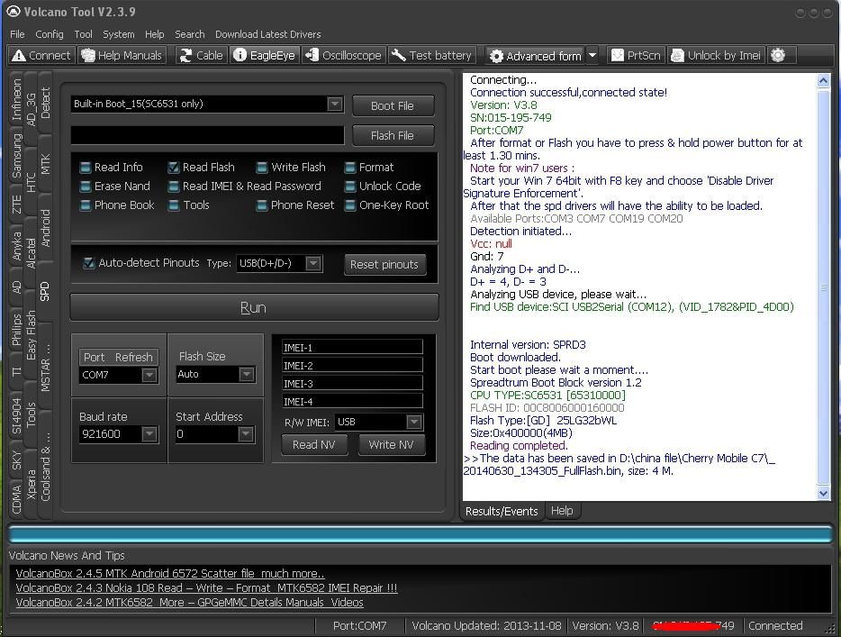

Cherry Mobile C7 Unlock Done w/ Volcano.
Model: Cherry Mobile C7
Problem: PLDT Lock
Procedure
Open Volcano V2.3.9
Click spd SC6531
Conect Pin P-07A)
Read Flash Para iwas disgrasya..

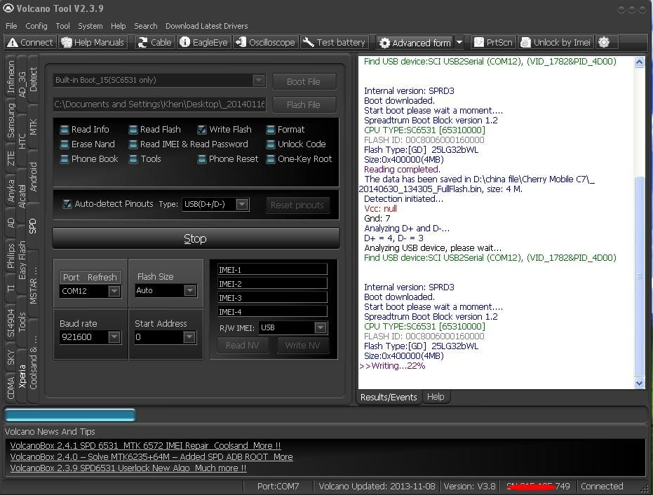

thin Rwite flash Download Unlock file

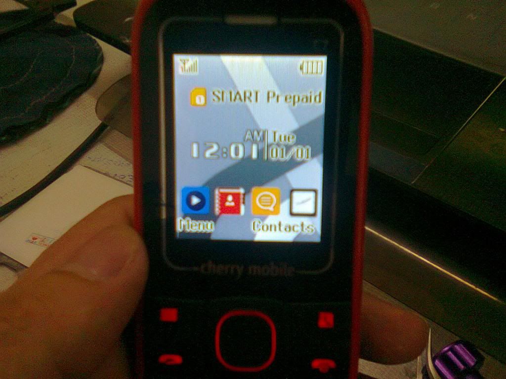

Cherry Mobile C7
