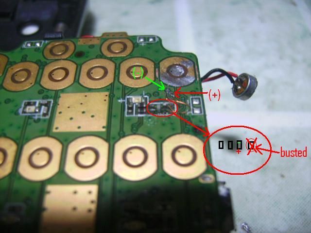

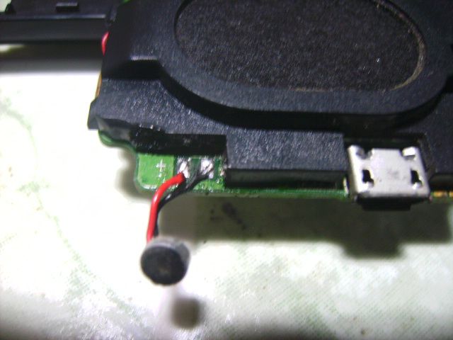

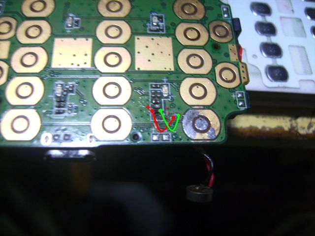

B BLIND Registered Joined Dec 23, 2014 Messages 2,965 Reaction score 14 Points 381 Location manila Feb 19, 2015 #1 Cherry Mobile D15tv Mic Solution...done share kulang... cherry mobile D15tv no mic/mouthpiece done action; first replace mic... no luck kahit kinuha kupa sa good unit... palitan mic, no luck... nakita ko yung isang capacitor busted na.., at line cut pa. here the solution...jump this line cut...done
