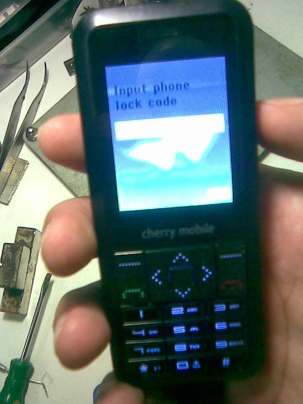

Heto ang phone hindi alam ang code..

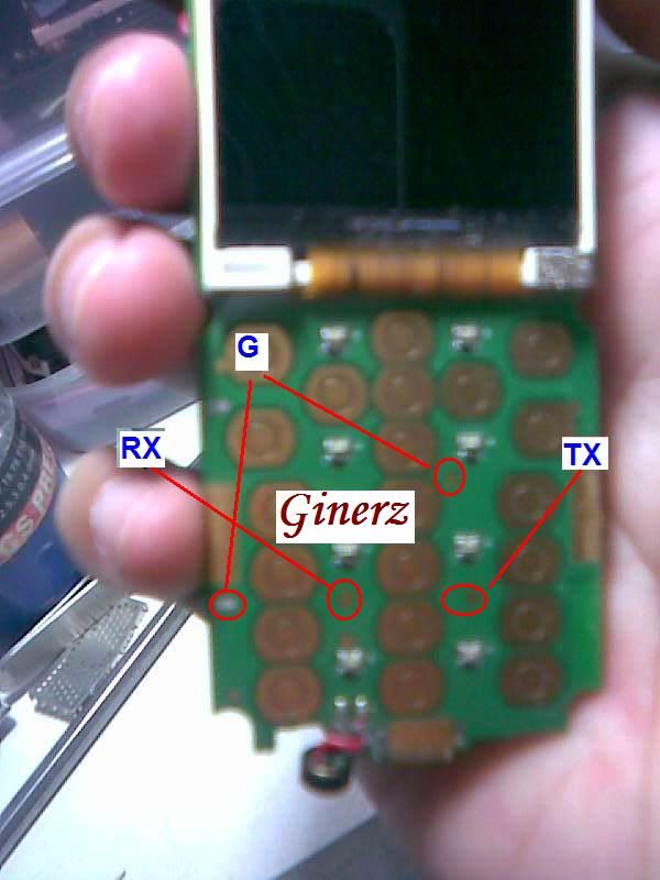

Dismantel Unit then look for Pinout

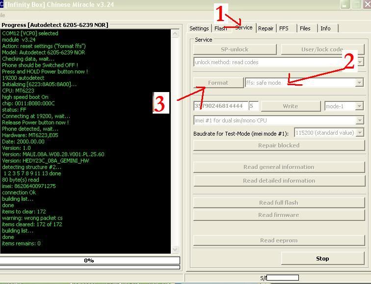

Service > Select SafeMode > Format
After format Tick Read General info for IMEI ..Need repair for 000000 IMEI

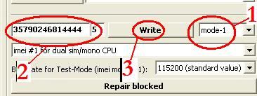

Select MODE-1 for 1st IMEI

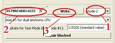

Select MODE-2 for 2nd IMEI

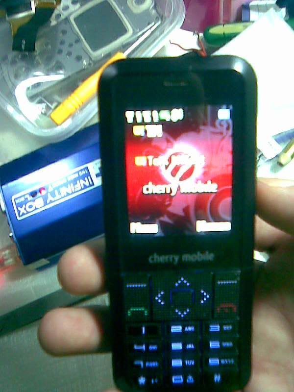

Tick GENERAL INFO Again.... SUAVE NA!!!
Finish Product
