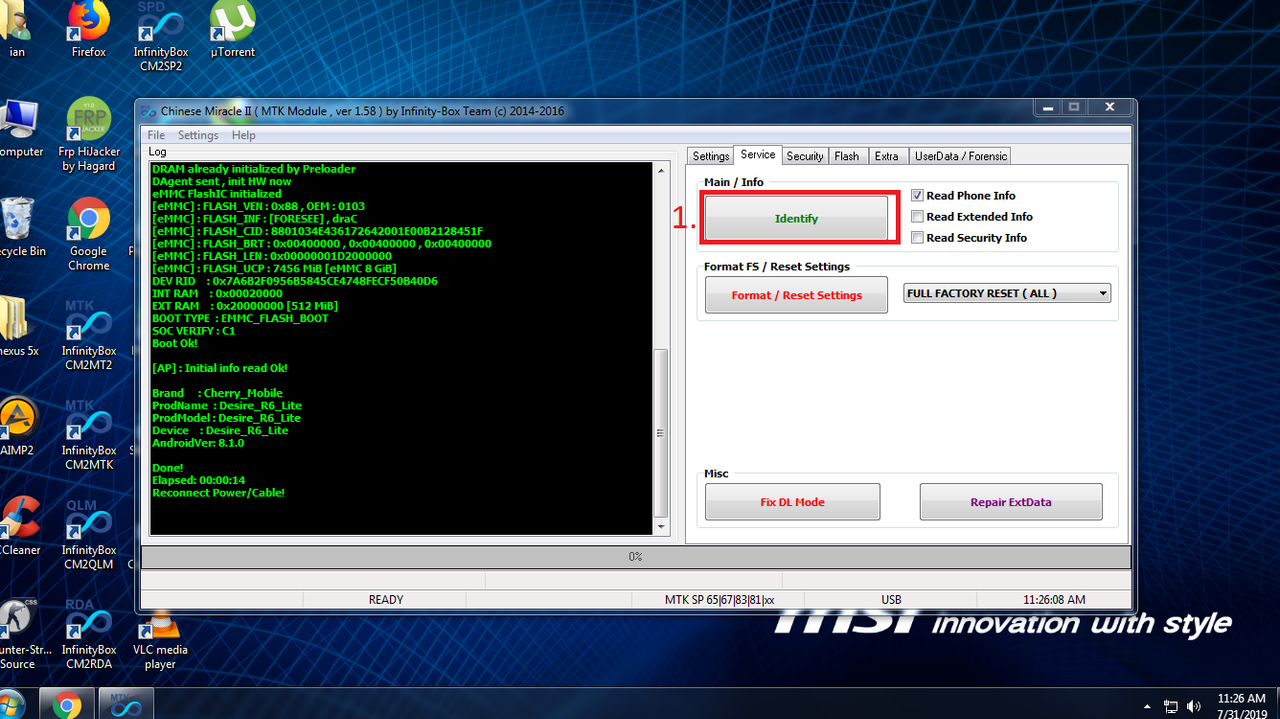

tools
1.usb
2.cm2 dongle box

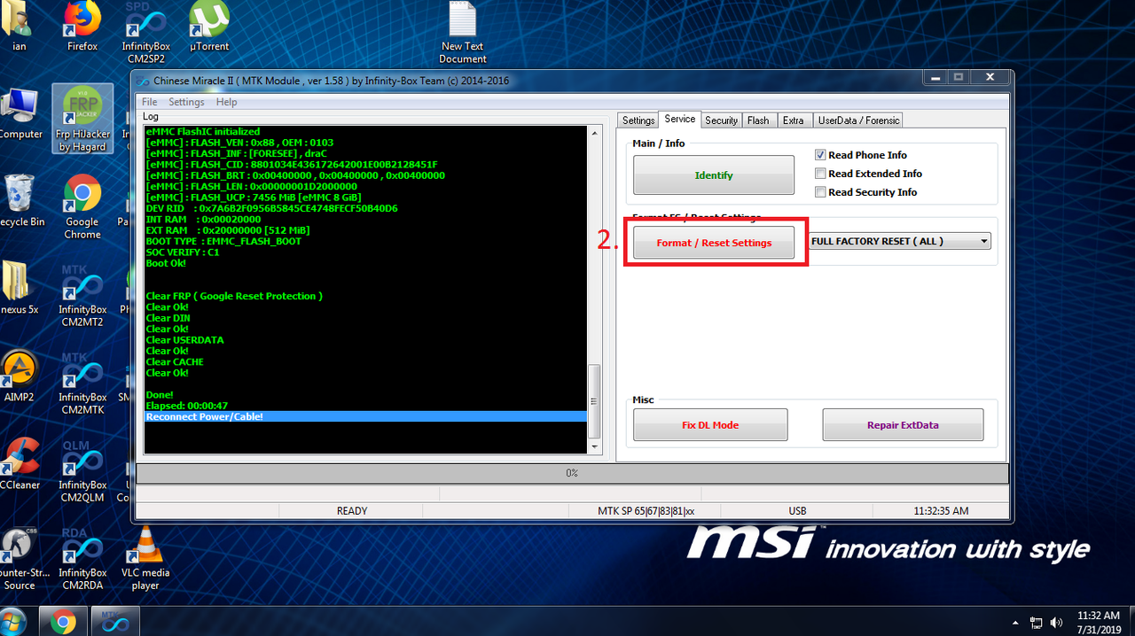

procedure follow my screenshot
logs
Wait for phone...
Phone found! [ 7 ]
Sync...
Inital Boot Ok!
BB_CPU_PID : 6580
BB_CPU_NME : [MediaTek] MT6580_S00
BB_CPU_EXT : 0xCA00 , 0x8A00 , 0x0000
Processing BROM stage
Settings for BROM configured!
SecCfgVal : 0x00000000
BromVer : 0x00FF
BLVersion : 0x0001
Processing DA stage
DA Select done, will use MTK_AllInOne_DA_v5.1624.16.07
Sending and initialize DA ...
Running DA ver.4.2 on BBID : 0x94
NAND Flash : NOT INSTALLED
eMMC Flash : 8801034E436172642001E00B2128451F
Initialize Memory ...
DRAM already initialized by Preloader
DAgent sent , init HW now
eMMC FlashIC initialized
[eMMC] : FLASH_VEN : 0x88 , OEM : 0103
[eMMC] : FLASH_INF : [FORESEE] , draC
[eMMC] : FLASH_CID : 8801034E436172642001E00B2128451F
[eMMC] : FLASH_BRT : 0x00400000 , 0x00400000 , 0x00400000
[eMMC] : FLASH_LEN : 0x00000001D2000000
[eMMC] : FLASH_UCP : 7456 MiB [eMMC 8 GiB]
DEV RID : 0x7A6B2F0956B5845CE4748FECF50B40D6
INT RAM : 0x00020000
EXT RAM : 0x20000000 [512 MiB]
BOOT TYPE : EMMC_FLASH_BOOT
SOC VERIFY : C1
Boot Ok!
Clear FRP ( Google Reset Protection )
Clear Ok!
Clear DIN
Clear Ok!
Clear USERDATA
Clear Ok!
Clear CACHE
Clear Ok!
Done!
Elapsed: 00:00:47
Reconnect Power/Cable!

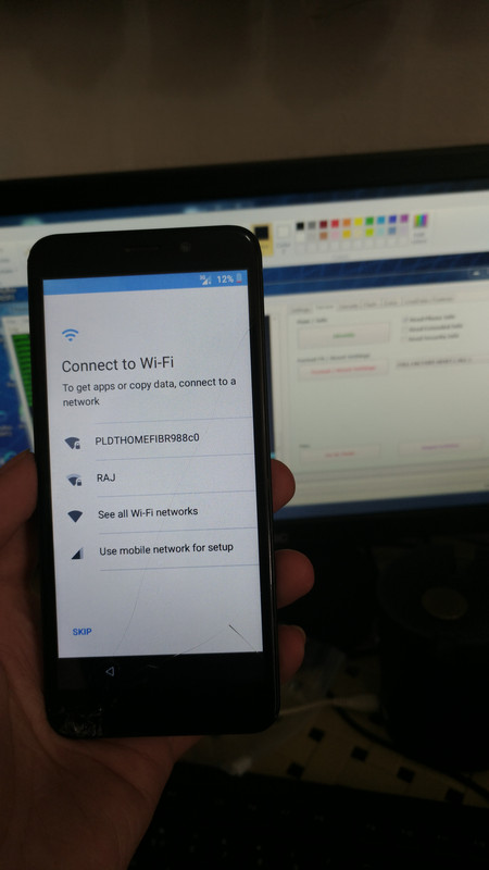

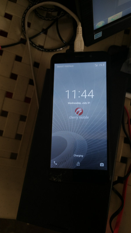

ito naman patunay ko
image hosting sites
hit like nalang mga boss if nakatulong sa inyo
1.usb
2.cm2 dongle box
logs
Wait for phone...
Phone found! [ 7 ]
Sync...
Inital Boot Ok!
BB_CPU_PID : 6580
BromVer : 0x00FF
BLVersion : 0x0001
Processing DA stage
SOC VERIFY : C1
Boot Ok!
Clear Ok!
Clear DIN
Clear Ok!
Clear USERDATA
Clear Ok!
Clear CACHE
Clear Ok!
Done!
Elapsed: 00:00:47
image hosting sites
