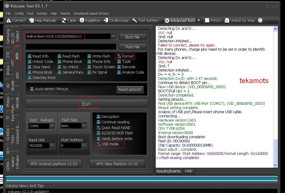

cherry mobile E2 hang DONE!
unit : cherry mobile E2
problem : hang on logo
chips : mtk 625A
tools
volcano box
jig P-07A
procedure
1. connect box open, open volcano GUI
2. connect jig to unit and power source
3. detect using spd anyka option
4. set pin out
5. select 625A bootfile
6. uncheck auto detect mode
7. check usb mode
8. select read flash for safety then run
9. reset pinout to avoid any error
10.check format option then click run!
on version 2.1.7 no need to disconnect jig....its run automatically
DONE!
after that imei 1,2,3 are the same
ihave only rebuild imei1 and imei2
imei3 is working properly!
i have also cherry mobile snap too many pattern problem, when i read info it shows "data analysis fail" thats why i didnt format the unit, because it may cause the unit brick!
