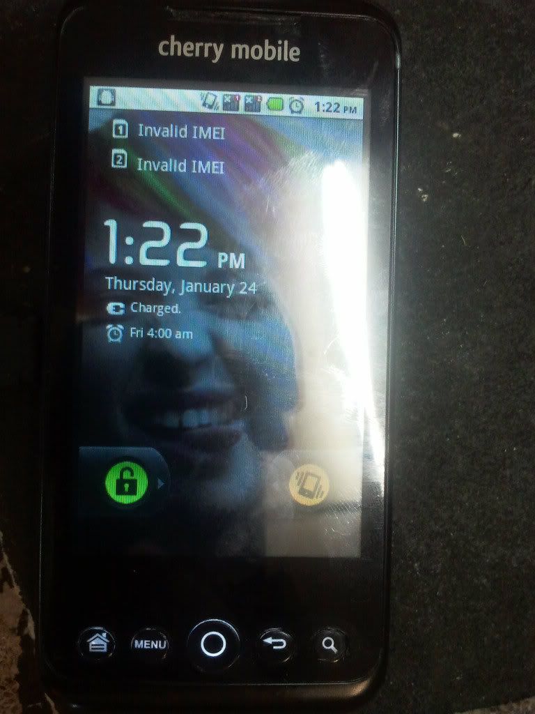

Just wanna share sa inyo mates
Cherry mobile eclipse 2.2 invalid imei
Click this bar to view the full image.
History:
Ni root lang ng kaibigan niya kaya nag invalid imei

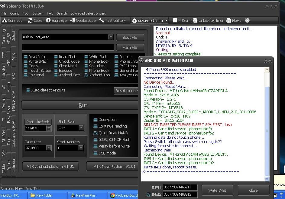

Procedure:
1.Open volcano tool
2.Go to detect tab then set pinouts
3.Open android tool
4. Input original imei
5. Thick write imei then follow message and wait until done

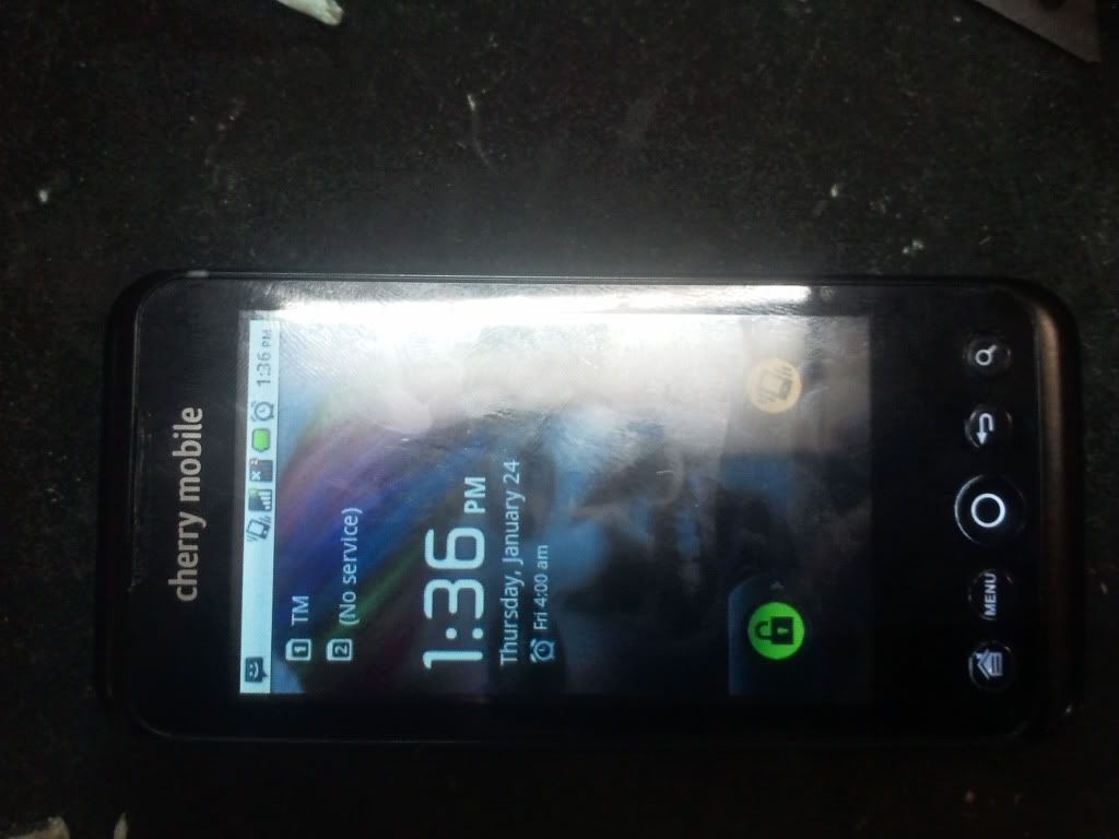

Sana makatu
