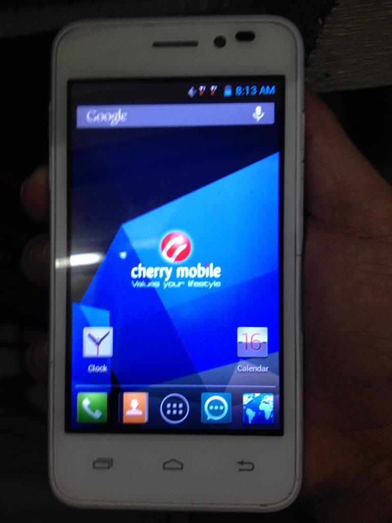

one status: Hang
Action taken: hard reset no luck
CM flare 2.0 stock rom
Procedure: lagay sa memory card Hold vol up + power button wait auto restart,
DONE

one status: Hang tas mag blank screen
Salamat sa Firmware mo boss... nayus ko ung cherry mobile v2.0 na tanggap ko...

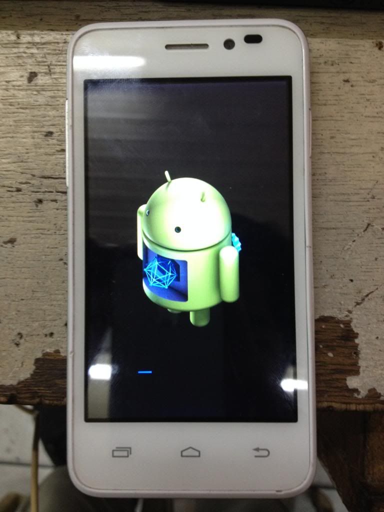

Cherry Mobile flare 2.0 Tested Firmware ...
Tested Firmware ...
Procedure:
Flashing Sd Card...
Iligay Sa Sd Card..
