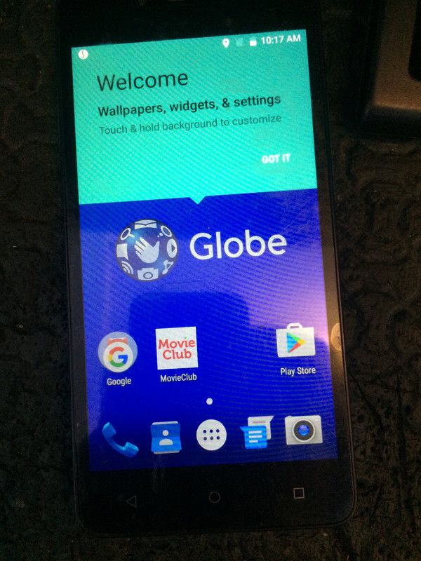

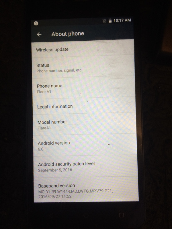

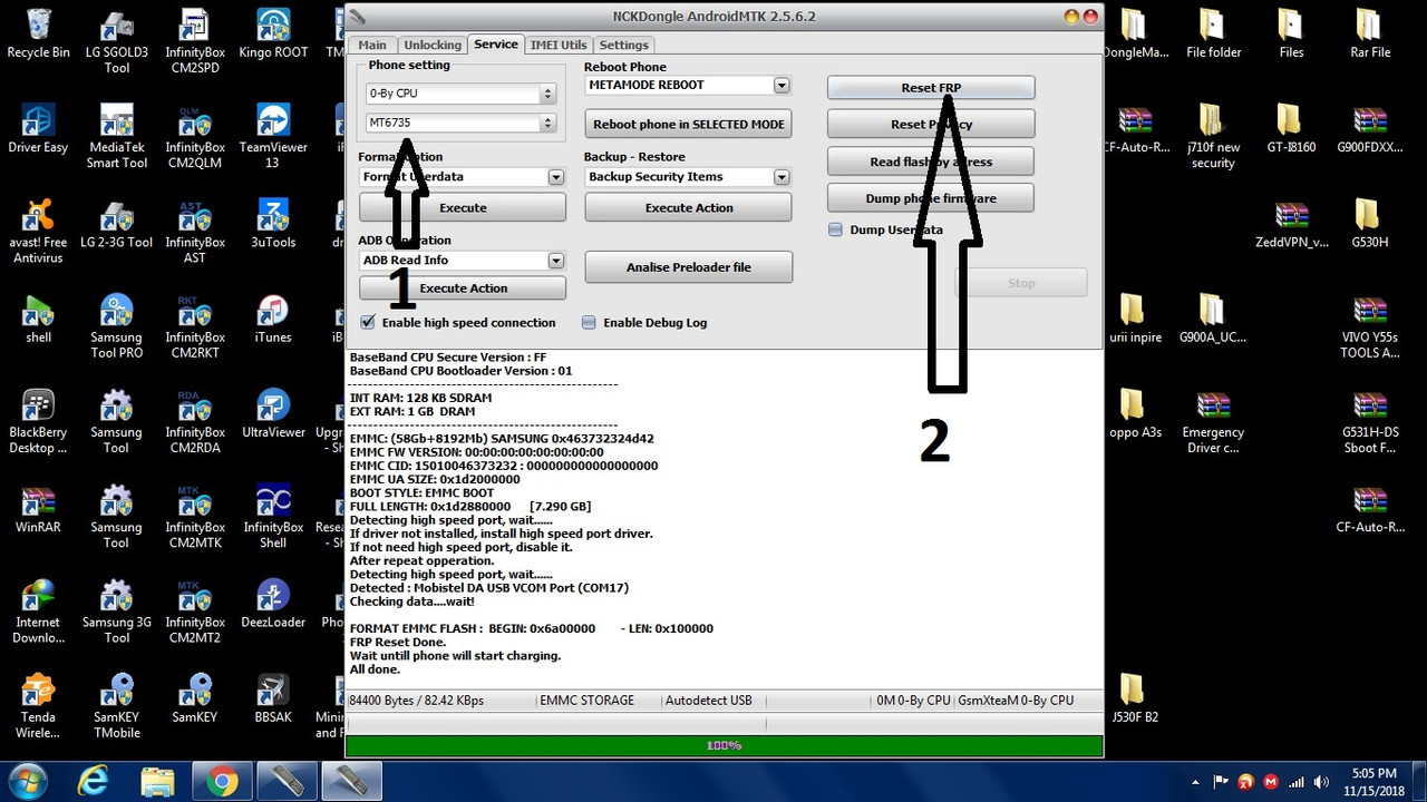

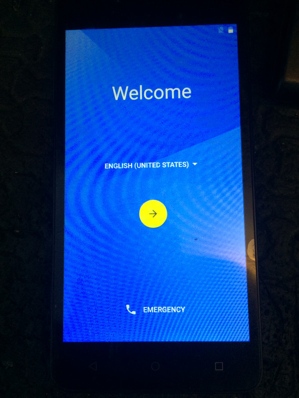

undreath Premium Account Joined Mar 20, 2017 Messages 282 Reaction score 44 Points 51 Location San pascual batangas Nov 15, 2018 #1 Share ko lang to mga boss nireset ni tumer di maalala google account nya. Open NCK crack tapos sundan nsa picture,off ang phone press volume up and down Disconnect battery tapos open nyo na Done hope na makatulong eto
