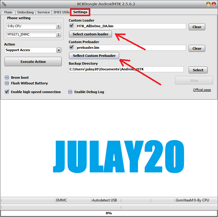

Open NCK Crack
go to Settings Load po ung na Download na DA at Preloader
Open Select Custom loader Load DA file
open select Custom Preloader Load Preloader.Bin

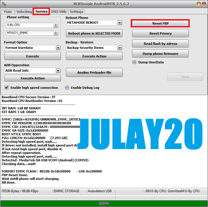

Click Services and click Reset FRP
Hold Vol + and Vol - the salpak USB
hantayin lang hangang ma tapos :D
INFO:
Code:
 Will be used loader: MTK_AllInOne_DA.bin
 Reinsert phone battery.
 Battery must be charged.
 Phone must be off with battery inside.
 Please insert USB cable now...
 Detected : MediaTek PreLoader USB VCOM (Android) (COM58)
 Phone detected...Please wait
 Sending DA agent, please wait...
 BaseBand CPU :MT6580_S00
 BaseBand CPU Secure Version : FF
 BaseBand CPU Bootloader Version : 01
 INT RAM: 128 KB SDRAM
 EXT RAM: 1 GB  DRAM
 EMMC: (58Gb+8192Mb) UNKNOWN_EMMC_DEVICE
 EMMC FW VERSION: 11:00:00:00:00:00:00:00
 EMMC CID: 13014E51324A39 : 000000000000000000
 EMMC UA SIZE: 0x1d2000000
 BOOT STYLE: EMMC BOOT
 FULL LENGTH: 0x1d2c00000      [7.293 GB]
 Detecting high speed port, wait......
 If driver not installed, install high speed port driver.
 If not need high speed port, disable it.
 After repeat opperation.
 Detected : MediaTek DA USB VCOM (Android) (COM59)
 Checking data....wait!
 FORMAT EMMC FLASH :  BEGIN: 0x18c00000       - LEN: 0x100000
 FRP Reset Done.
 Wait untill phone will start charging.

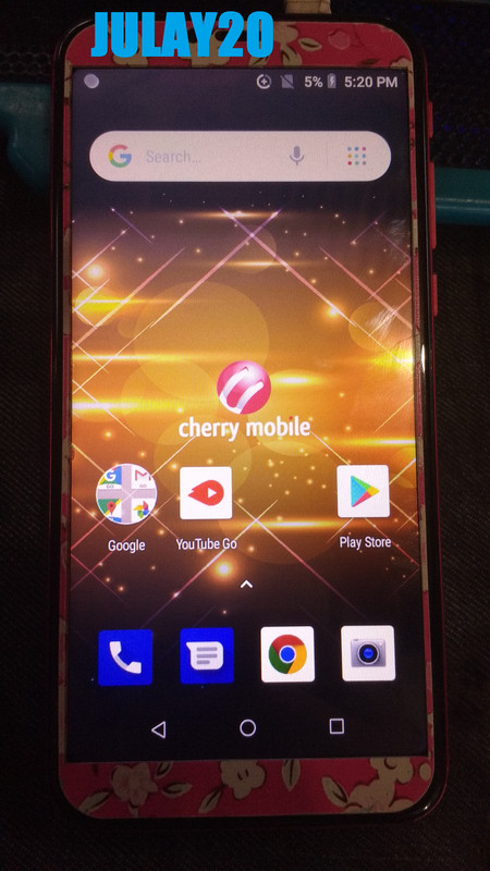

 All done.
