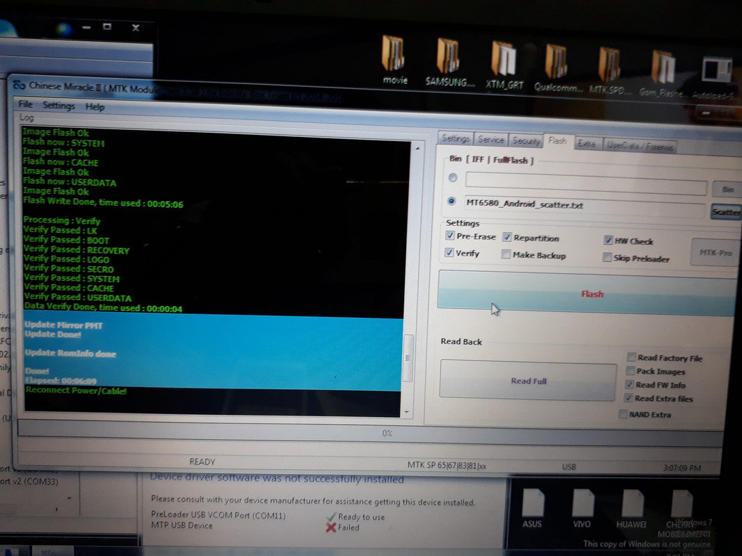

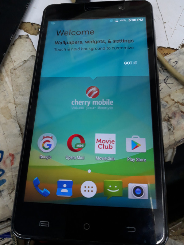

goodafternoon mga ka ANTECH share ko lang gawa ko CM FLare J2 no power pero na dettect pa sa Laptop...kya ginawa ko flashing via CM2dongle at sa Tested Firmware..done
open cm2dongle MTKmodule
press and hold bothkey
insert usb cable
firmware here DL......

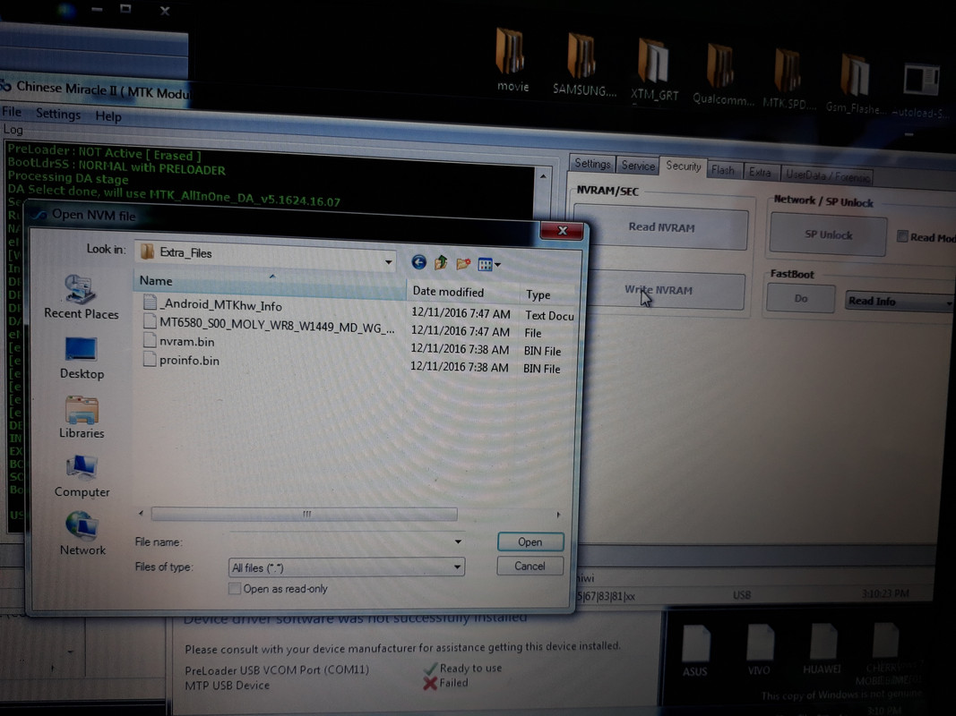

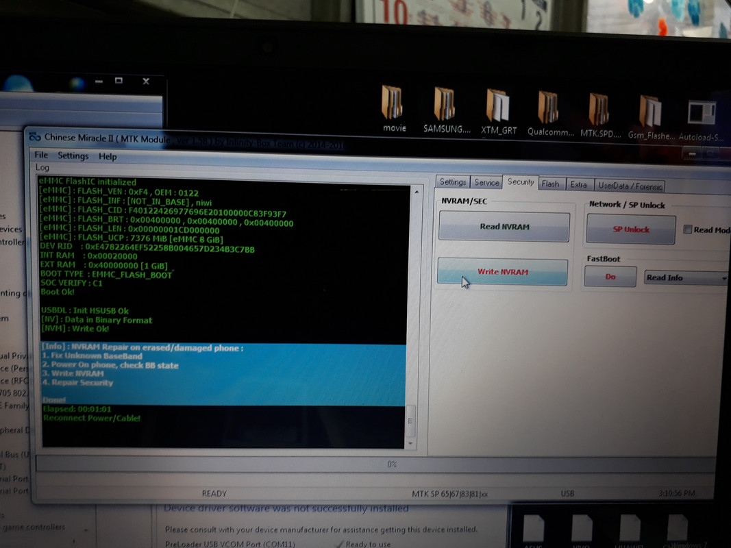

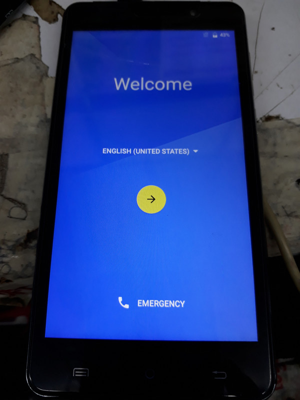

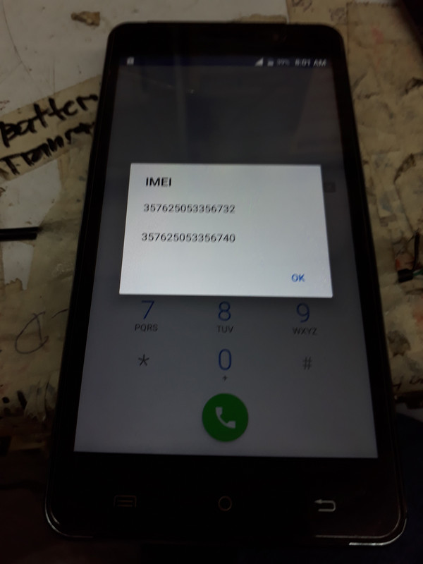

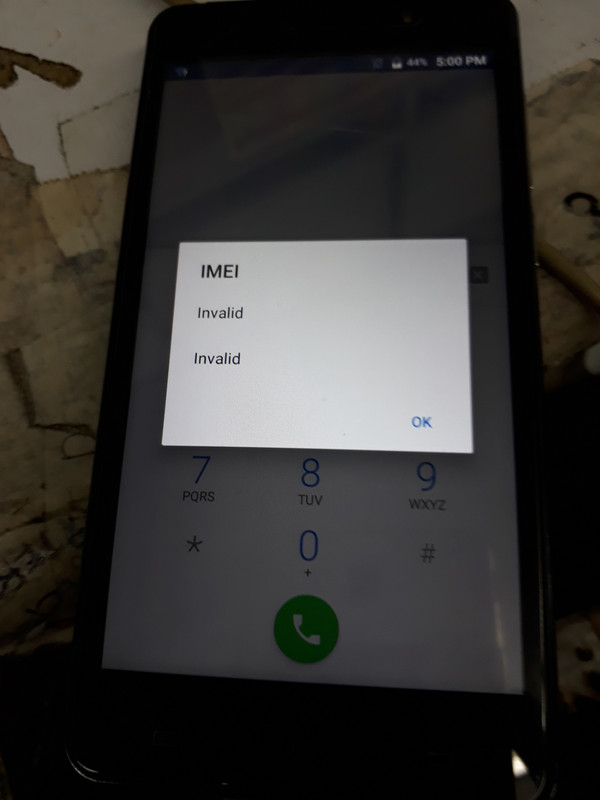

Flashing Success pro INVALID IMEI....ito nman ginawa ko...
Done
