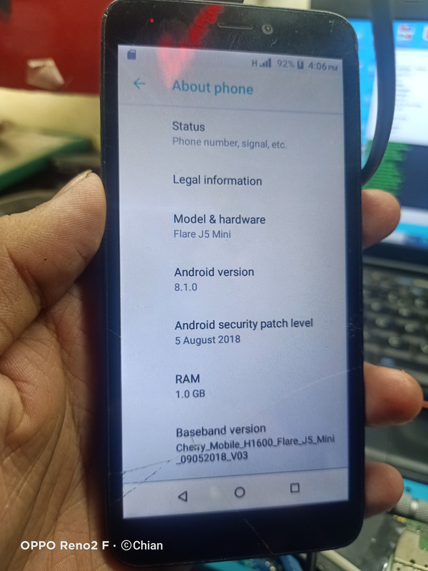

Good day po sa inyong lahat. Today may narecieve po akong unit 'Cherry mobile J5 mini'
Auto restart.
Proceed na po tayo.

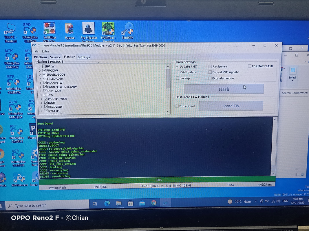

Dl this file https://www.mediafire.com/file/sjryjtk24iq1m6t/Flare+J5+Mini+V03+Pac.zip/file
Pass: changsm1994
Open cm2sp2 click SC7715X BASE into SC7731E [SC7731E_eMMC_1GB_0S]
Now click 'Flasher' tab and load firmware then click 'Flash' and hold volume up and insert usb cable.

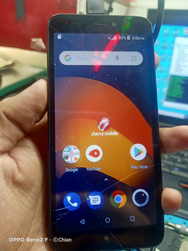

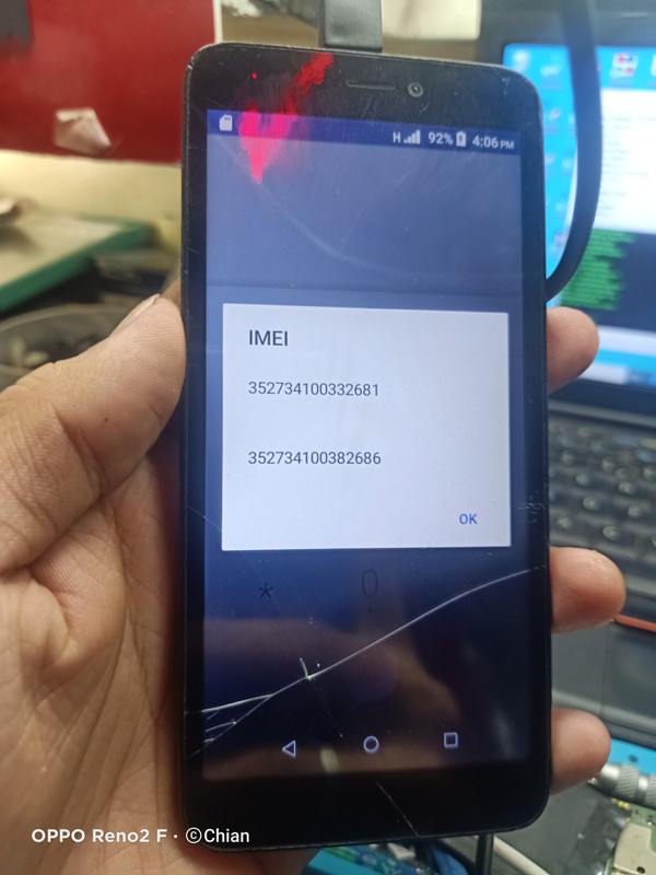

At hintayin lang matapos. Heto naman po ang proof ko.
