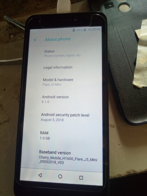

flare j5 mini hang on logo done sa tested firmware via cm2 sp2
tested firmware link sa baba

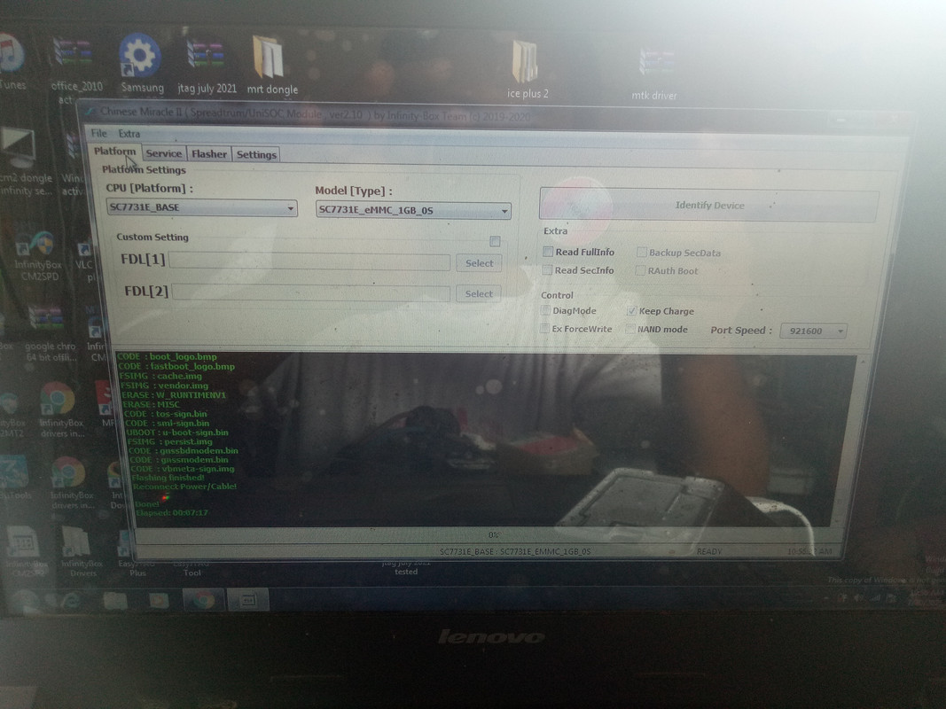

open cm2 sp2 and select cpu--- platform (SC7731E_BASE) and MOdel (type SC7731EMMC_1GB_0S)

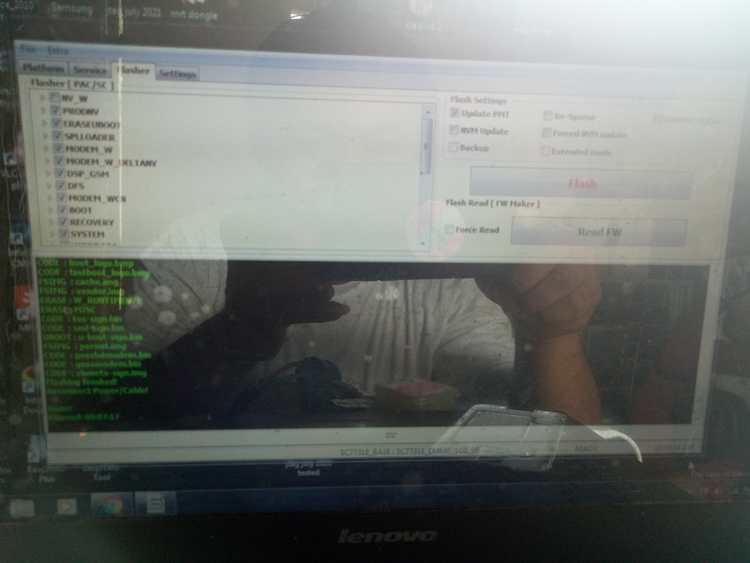

Then tuloy na sa flashing select pac file for j5 mini firmware then flash and wait until matapos
