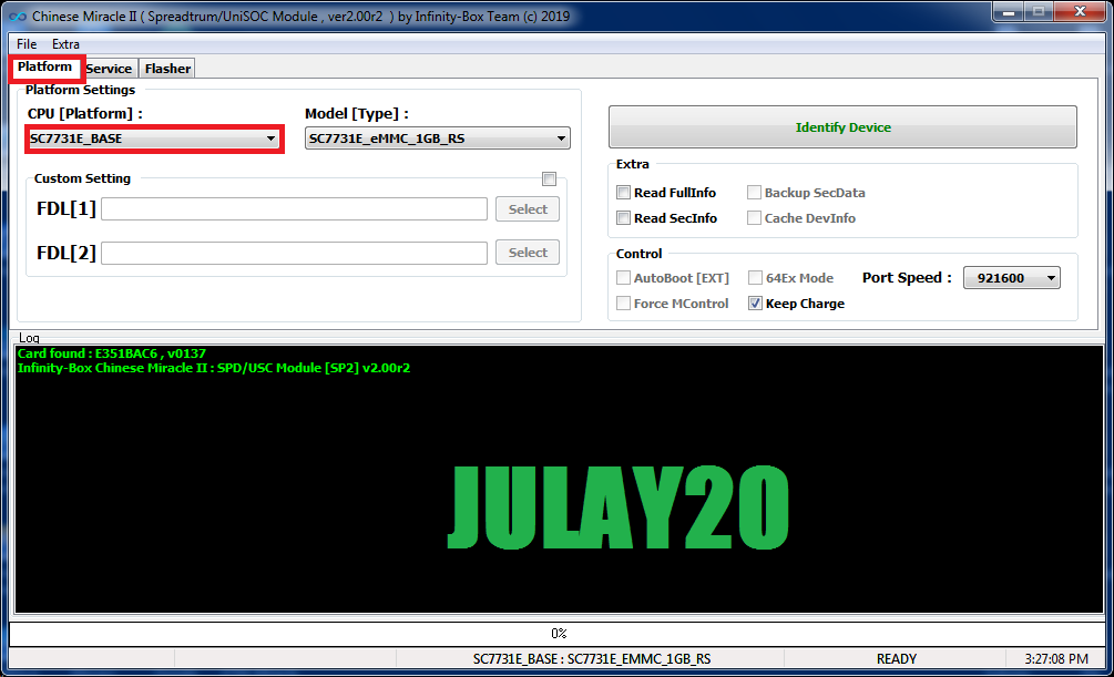

Open CM2 SPD V2.00r2
PlatForm CPU [Platform] select SC7731E_BASE

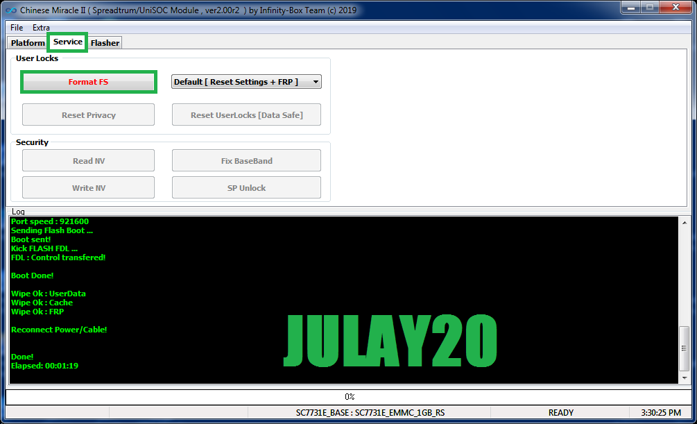

Click Service Format FS
Hold Voll Down saksak USB
pag omilaw yung flash sa likod ok lang yan hayan mo lang :D
Wait... mo lang ma tapos.

Log's:
Code:
Card found : E351BAC6 , v0137
Infinity-Box Chinese Miracle II : SPD/USC Module [SP2] v2.00r2
Operation : Format FS / Reset Settings [ v2.00r2 ]
Mode : Default [ Reset Settings + FRP ]
1. Power off device, wait 10-15 seconds
2. Press and hold BooKey ( 1 : BOTH VOL , 2 : VOL+ , 3 : VOL- )
3. Insert cable in device!
Wait for device ...
Device Connected!
ERROR : Protocol HandShake failed!
Error : Fail to init protocol!
Remove battery, cable. Check cable and connection. Repeat operation!
Reconnect Power/Cable!
Wait for device ...
Device Connected!
BootVersion : SPRD3
Boot : INF : 0_SC7731E_BASE : SC7731E_eMMC_1GB_RS
Sending Init Boot ...
Boot sent!
Kick FDL ...
BootVersion : Spreadtrum Boot Block version 1.1
Protocol setup ...
Port speed : 921600
Sending Flash Boot ...
Boot sent!
Kick FLASH FDL ...
FDL : Control transfered!
Boot Done!
Wipe Ok : UserData
Wipe Ok : Cache
Wipe Ok : FRP
Done!
Elapsed: 00:01:19
