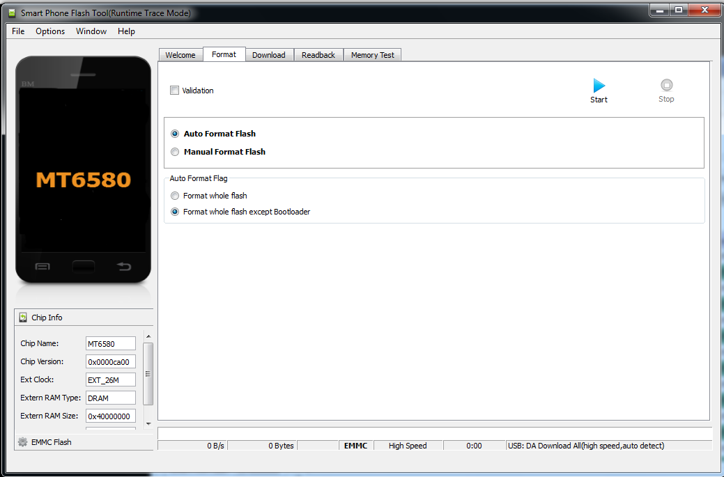

dL Flashtools ; https:https://spflashtools.com/windows/sp-flash-tool-v5-1620
Open sp tools . go to Format sec/
format lang unit !
[dead na unit]

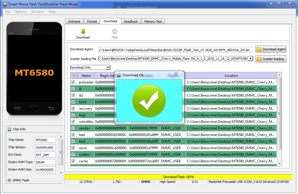

go to DOWNLOAD SEC /
LOAD SCATTER FILES ! DOWNLOAD ONLY !
