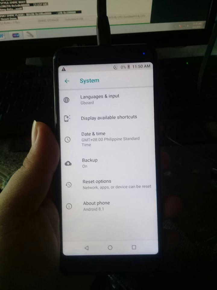

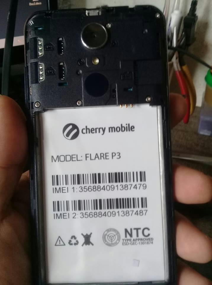

wesly1986
problim frp
Battery must be charged.
Phone must be off with battery inside.
Please insert USB cable now...
Detected : MediaTek PreLoader USB VCOM (Android) (COM4)
Phone detected...Please wait
Sending DA agent, please wait...
BaseBand CPU :MT6580_S00
BaseBand CPU Secure Version : FF
BaseBand CPU Bootloader Version : 01
INT RAM: 128 KB SDRAM
EXT RAM: 1 GB DRAM
EMMC: (57Gb+8192Mb) KSI 0x454838454538
EMMC FW VERSION: 01:00:00:00:00:00:00:00
EMMC CID: 70010045483845 : 000000000000000000
EMMC UA SIZE: 0x1c8000000
BOOT STYLE: EMMC BOOT
FULL LENGTH: 0x1c8c00000 [7.137 GB]
Checking data....wait!
FORMAT EMMC FLASH : BEGIN: 0x18ba0000 - LEN: 0x100000

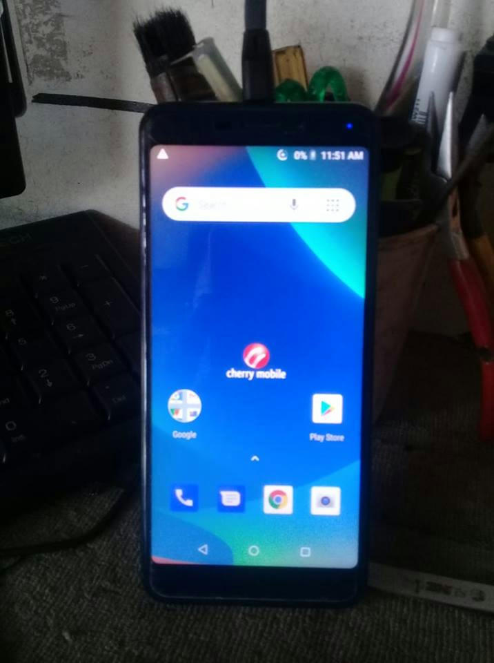

FRP Reset Done.
Wait untill phone will start charging.
All done.
done
