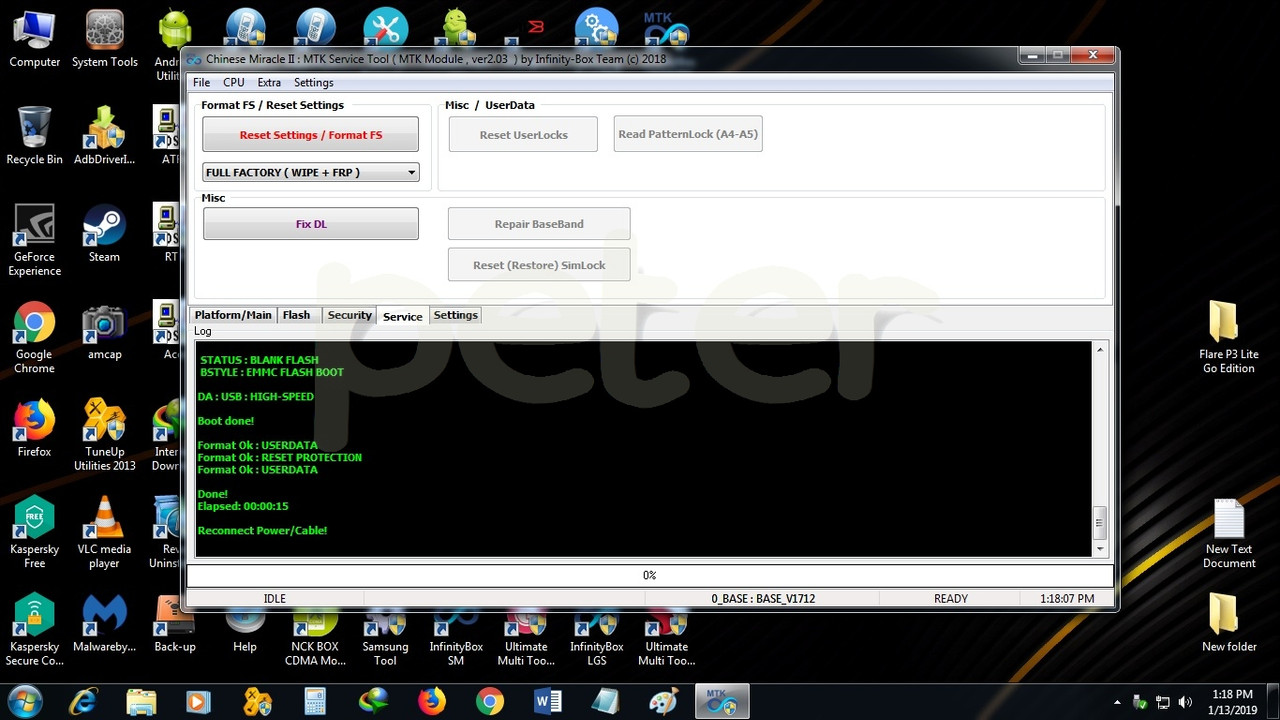

Cherry Mobile Flare P3 Lite (Go Edition) FRP
Problem : FRP
Solution : Reset FRP
Tools : Infinity Box Dongle
CA-101 Micro USB Cable
Procedures : Run InfinityBox CM2MT2 GUI
Click Service Tab
Select Full Factory (Wipe+FRP)
Click Reset Settings/Format FS Button
Power off Phone
Insert CA-101 Micro USB Cable
Wait till Format Userdata and Reset Protection done

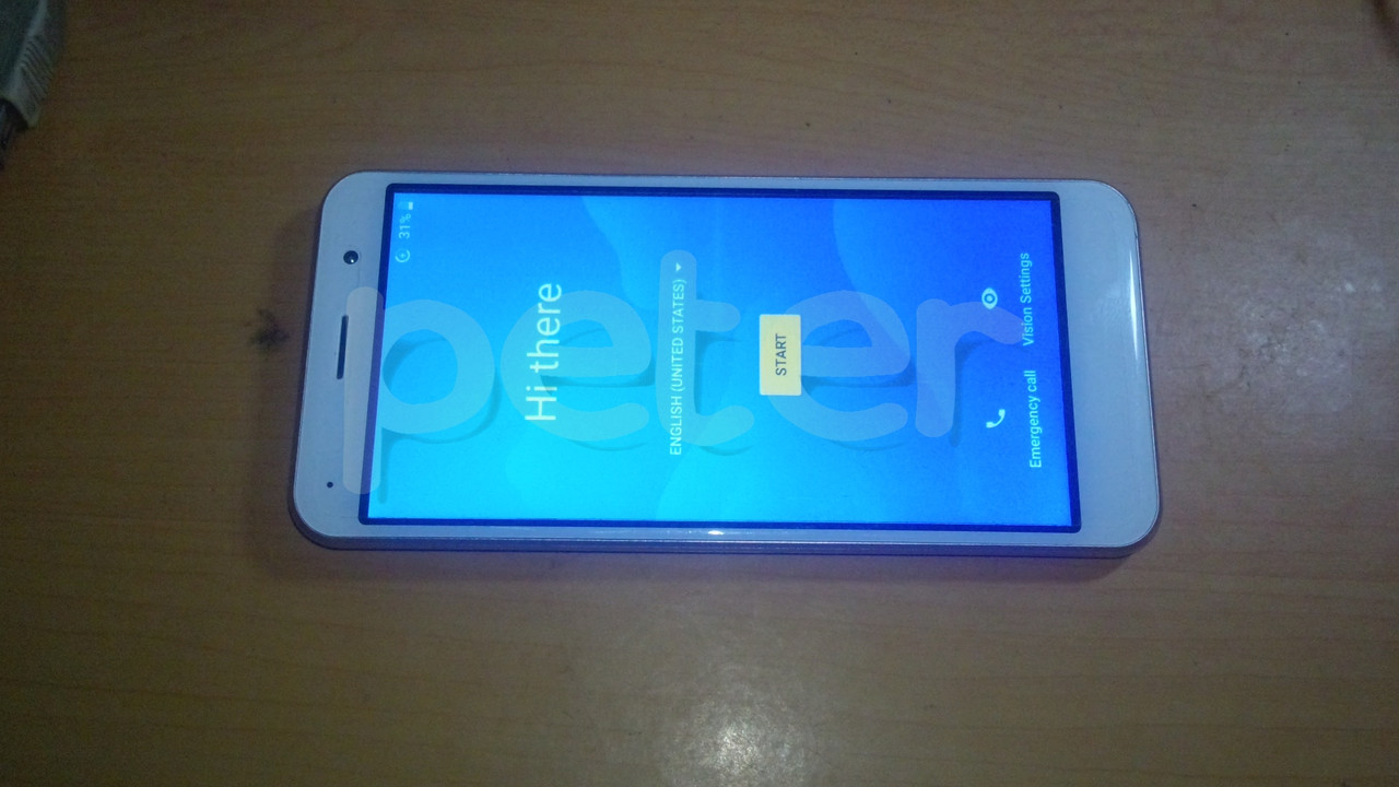

Result :
Done.....
