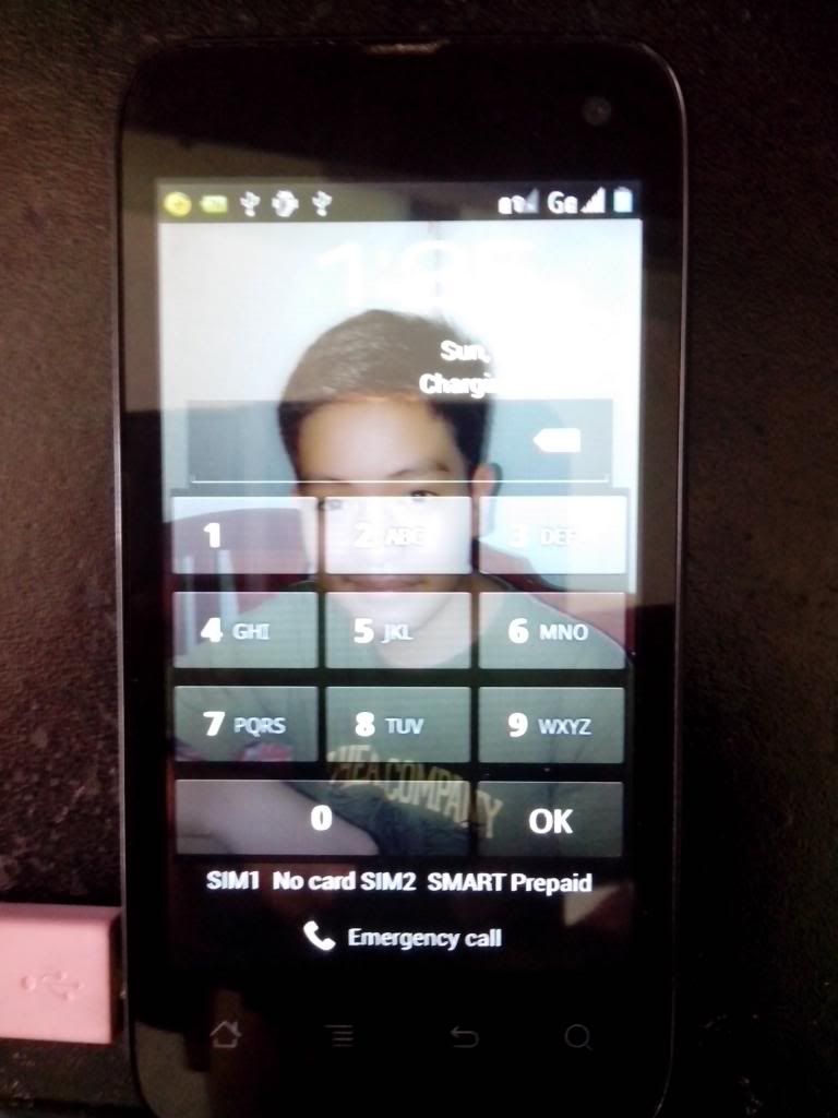

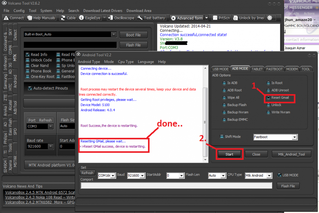

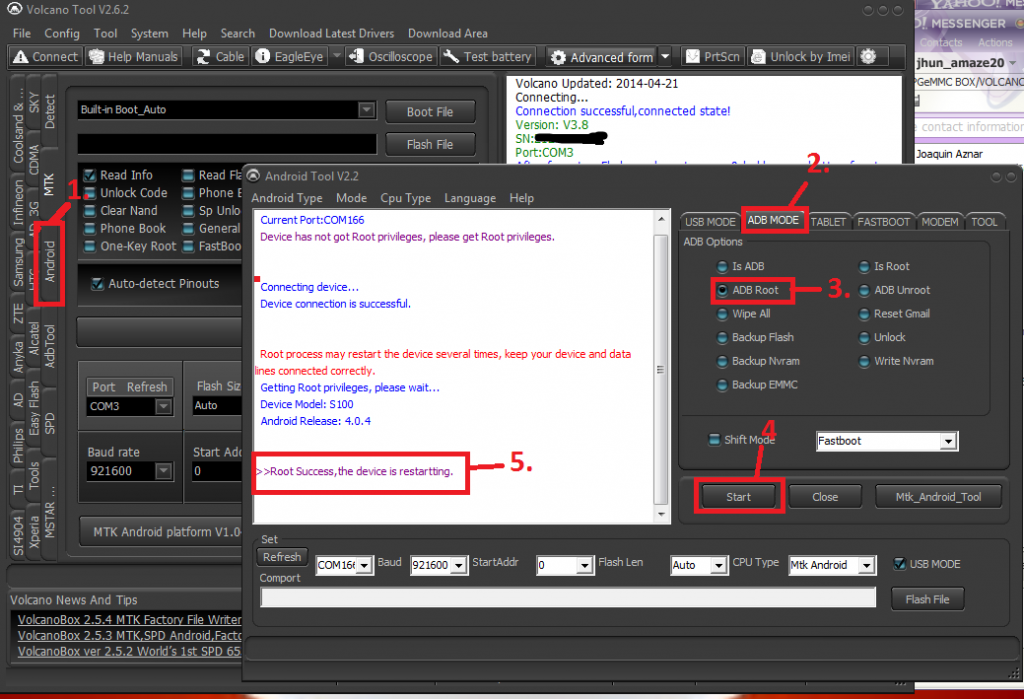

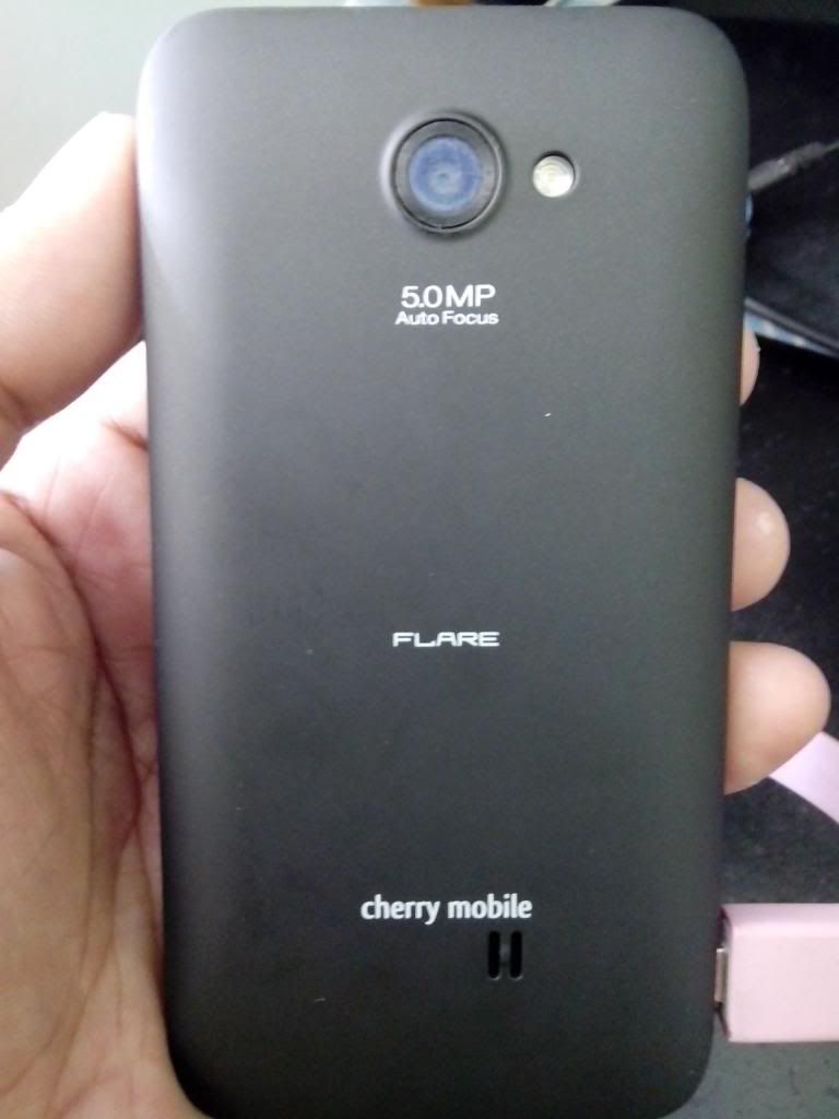

A AltF4 Registered Joined Sep 3, 2014 Messages 1,285 Reaction score 7 Points 181 Mar 4, 2015 #1 Share ko lang po bossing... Model; Cherry Mobile Flare S100 Problem; Pattern Lock/Password Lock Solution; RESET G-MAIL via VOLCANO.. Ito ang unit; Swerte naka USB DEBUGGING.. Kaya ROOT muna... After ROOT,G-MAIL RESET na..
