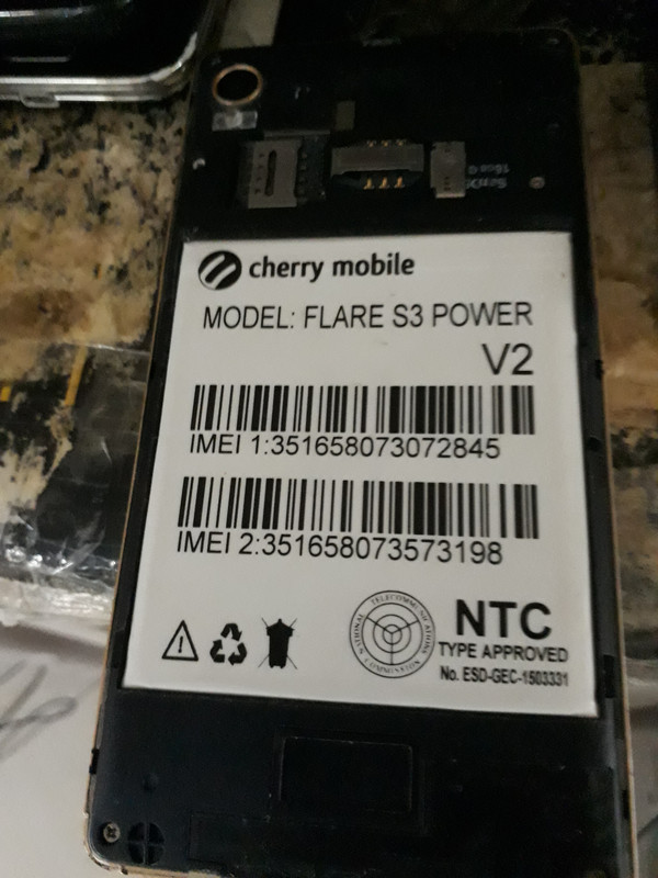

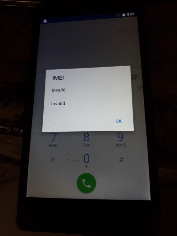

goodmorning share ko lang INVALID IMEI wla akung mahanap na scatter files
at nakalimutan ko e backup ang phone..kaya hanap ako sa tahanan buti nlang my nakita..

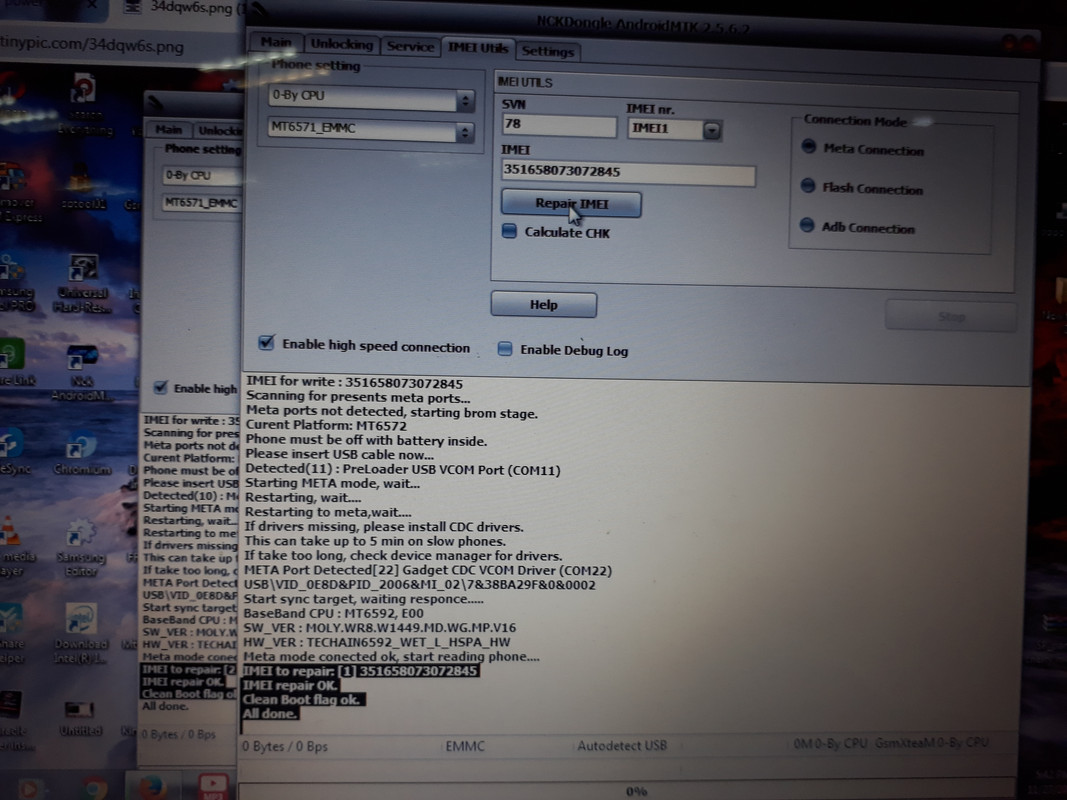

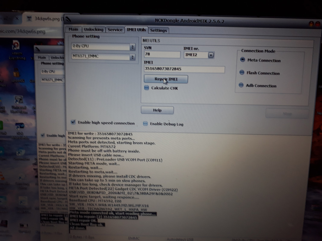

1. open NCKcracktool
2. press and hold volume up
3. insert usb cable
proccedure: pakisundan at tingnan nlang..

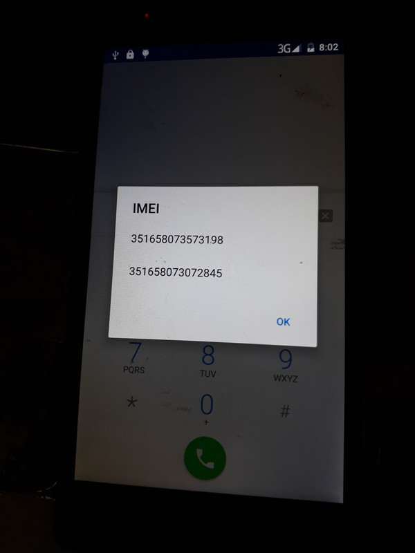

IMEI 1.
IMEI 2.
JUST HIT THANKS FOR THIS USEFUL REFERENCE
