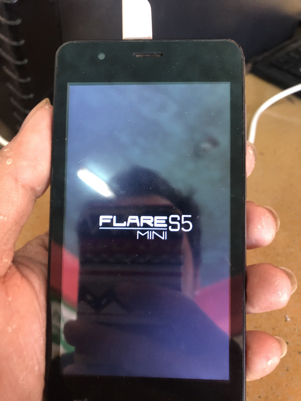

CHERRY MOBILE FLARE S5 MINI HANG LOGO BY CM2

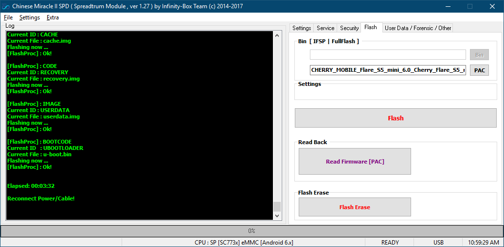

FLASHING CM2
Operation : Flash [ v1.27 ]
======= Flash
Files set for flashing :
[ MCU ] : CHERRY_MOBILE_Flare_S5_mini_6.0_Cherry_Flare_S5_mini_V1.4_11152016_Flare_S5_mini.pac
CRVersion : BP_R1.0.0
PacCPUinfo : SC77xx
PacVersion : SC7731_eMMC_MOBILE_FLARE_S5_MINI_INFINITY-BOX
File : Infinity_fdl1.bin
File : Infinity_fdl2.bin
File : nvitem_w.bin
File : nvitem_wcn.bin
File : prodnv.img
File : u-boot-spl-16k.bin
File : sc7731C_CP0_modem.bin
File : DSP_DM_Gx.bin
File : sc8830g_modem_CP2_WCN_Trunk_W16.28.5_Release.bin
File : logo_480x854.bin
File : fblogo_480x854.bin
File : boot.img
File : system.img
File : sysinfo.img
File : cache.img
File : recovery.img
File : userdata.img
File : u-boot.bin
1. Remove battery. Insert battery back
2. Press and hold 'VolumeUp' and 'VolumeDown' keys
-> Alternative : just ONE 'VolumeUp' or 'VolumeDown' key
3. Insert cable
==== Wait for phone...
Phone found! [ 42 ]
Port Opened
Sync...
InitBoot Done [ 0x81 ] , Ver : SPRD3
Sync...
Sending FDL
[Info] : If SW freeze here more, than 15 seconds - remove cable
PickUp loaders from pac
FDL Ready!
Boot Ver : Spreadtrum Boot Block version 1.1
Sending FLASH FDL
FLASH FDL Ready!
Boot Ok!
FlashMode Set : Ok!
PMTManager : Load 0x19 records
PMTManager : PMT Update Ok!
Flashing now
[FlashProc] : CODE
Current ID : PRODNV
Current File : prodnv.img
Flashing now ...
[FlashProc] : Ok!
[FlashProc] : ERASE
Current ID : ERASEUBOOT
Current Part : uboot
[FlashProc] : Ok!
[FlashProc] : ERASE
Current ID : FLASH
Current Part : wruntimenv1
[FlashProc] : Ok!
[FlashProc] : ERASE
Current ID : FLASH_WCN
Current Part : wcnruntimenv1
[FlashProc] : Ok!
[FlashProc] : ERASE
Current ID : ERASEMISC
Current Part : misc
[FlashProc] : Ok!
[FlashProc] : BOOTCODE
Current ID : SPLLOADER
Current File : u-boot-spl-16k.bin
Flashing now ...
[FlashProc] : Ok!
[FlashProc] : CODE
Current ID : MODEM_W
Current File : sc7731C_CP0_modem.bin
Flashing now ...
[FlashProc] : Ok!
[FlashProc] : CODE
Current ID : DSP_W
Current File : DSP_DM_Gx.bin
Flashing now ...
[FlashProc] : Ok!
[FlashProc] : CODE
Current ID : MODEM_WCN
Current File : sc8830g_modem_CP2_WCN_Trunk_W16.28.5_Release.bin
Flashing now ...
[FlashProc] : Ok!
[FlashProc] : CODE
Current ID : BOOTLOGO
Current File : logo_480x854.bin
Flashing now ...
[FlashProc] : Ok!
[FlashProc] : CODE
Current ID : FASTBOOT_LOGO
Current File : fblogo_480x854.bin
Flashing now ...
[FlashProc] : Ok!
[FlashProc] : CODE
Current ID : BOOT
Current File : boot.img
Flashing now ...
[FlashProc] : Ok!
[FlashProc] : IMAGE
Current ID : SYSTEM
Current File : system.img
Flashing now ...
[FlashProc] : Ok!
[FlashProc] : CODE
Current ID : SYSINFO
Current File : sysinfo.img
Flashing now ...
[FlashProc] : Ok!
[FlashProc] : IMAGE
Current ID : CACHE
Current File : cache.img
Flashing now ...
[FlashProc] : Ok!
[FlashProc] : CODE
Current ID : RECOVERY
Current File : recovery.img
Flashing now ...
[FlashProc] : Ok!
[FlashProc] : IMAGE
Current ID : USERDATA
Current File : userdata.img
Flashing now ...
[FlashProc] : Ok!
Current ID : UBOOTLOADER
Current File : u-boot.bin
Flashing now ...
[FlashProc] : Ok!
Elapsed: 00:03:32
Reconnect Power/Cable!
