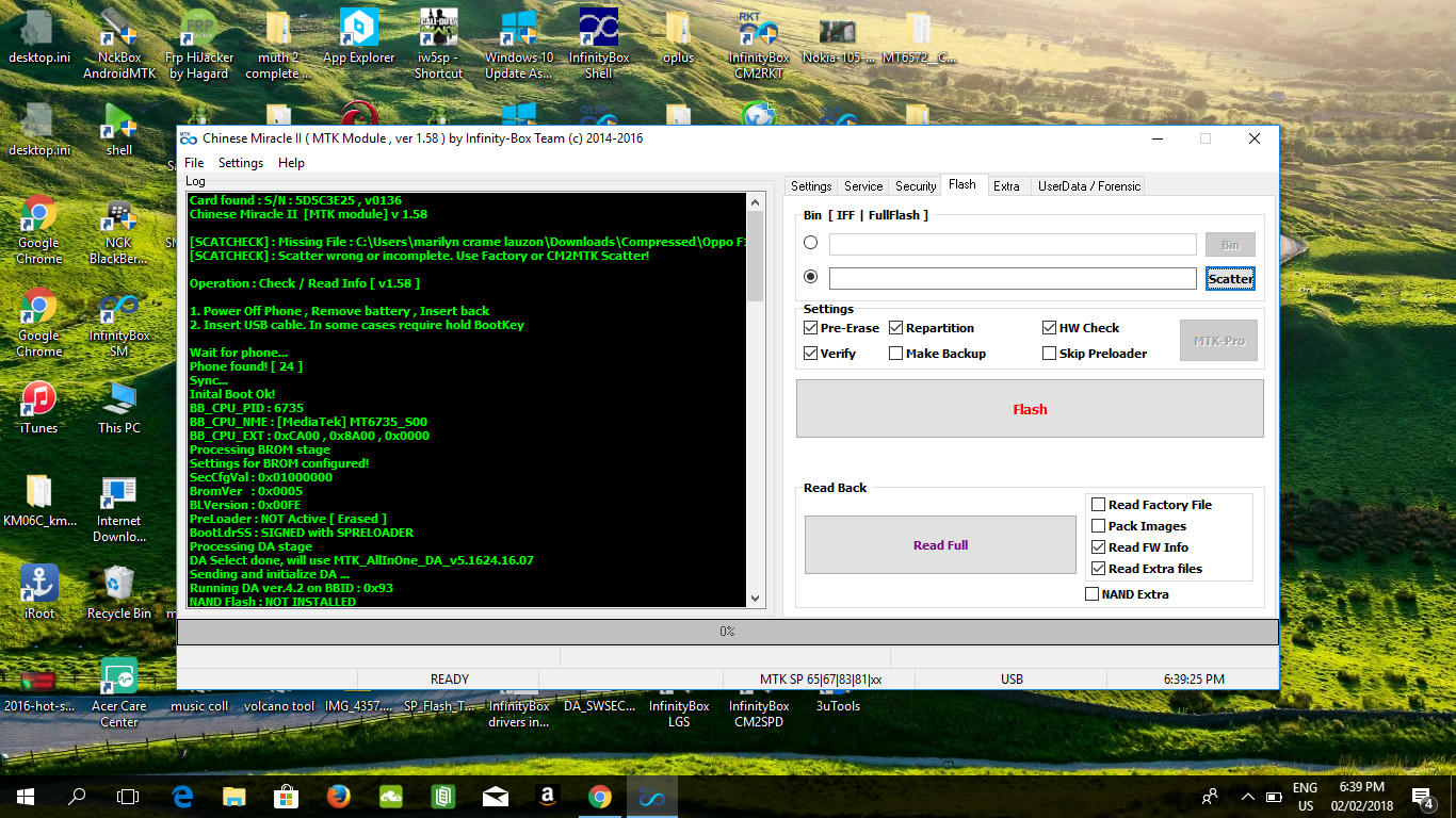

cherry mobile flare s6 frp, naka lock ang bootlader(secureboot) try nck no lock, try cm2 done with firm
ito ginawa ko sinubukan ko gamitin yung firmware ng oppo f1s na pang rfp remove.
tools:cm2 dongle
micro usb cable
steps:
1,dl firmware:Oppo F1s.rar
2, open cm2 dongle mtk module
3, select flash and select scatter file: WARNING WAG IFLASH..
4, select service click read phone/frp reset protection
5, press volume up and down then salpak usb cable

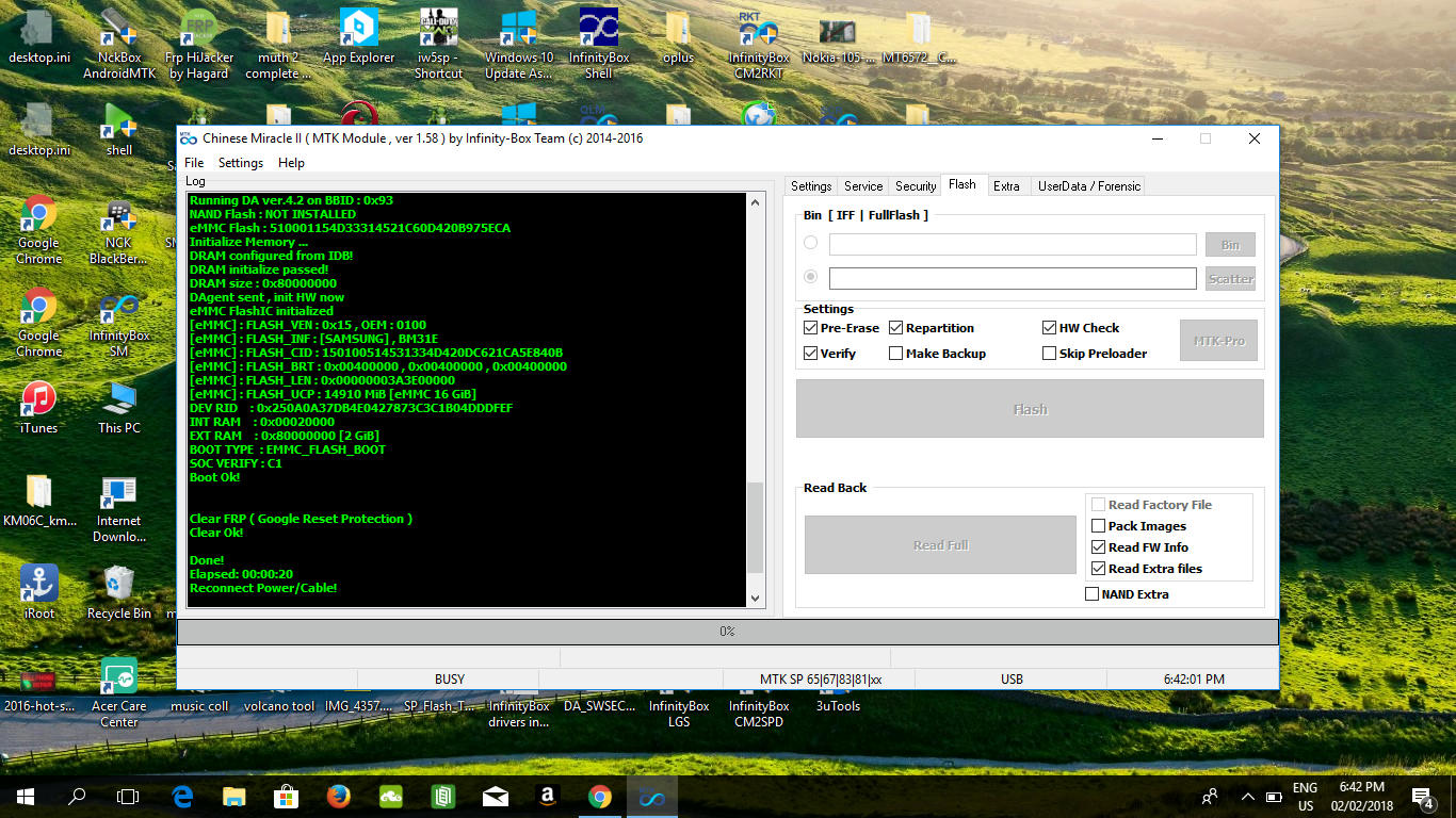

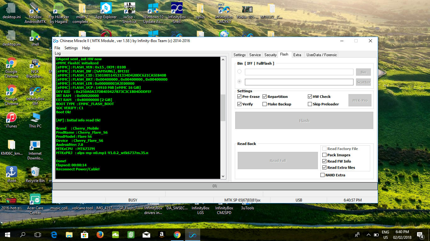

read phone info:
frp remove:
done:
[DA_ERROR] : DRAM Configure failed!
ErroCode : 0x2003
EMICFG_NOT_FOUND
Firmware selected, but it NOT compatible!
Boot Error!
Operation Failed
Elapsed: 00:00:27
Reconnect Power/Cable!
yan ang error boss
