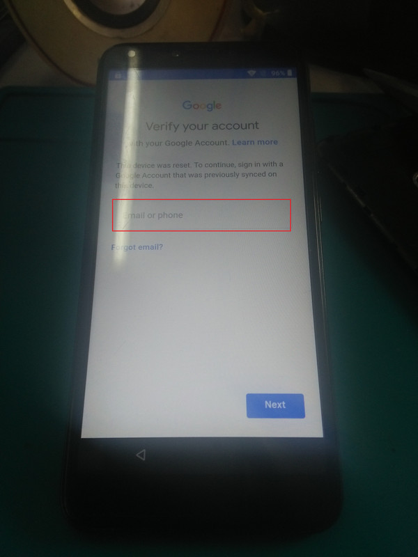

HISTORY: Ne reset ni tumer tapos nagkaganyan na daw.
PROBLEM:
https://postimages.org/

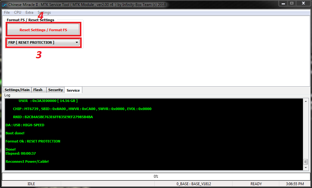

PROCEDURE:

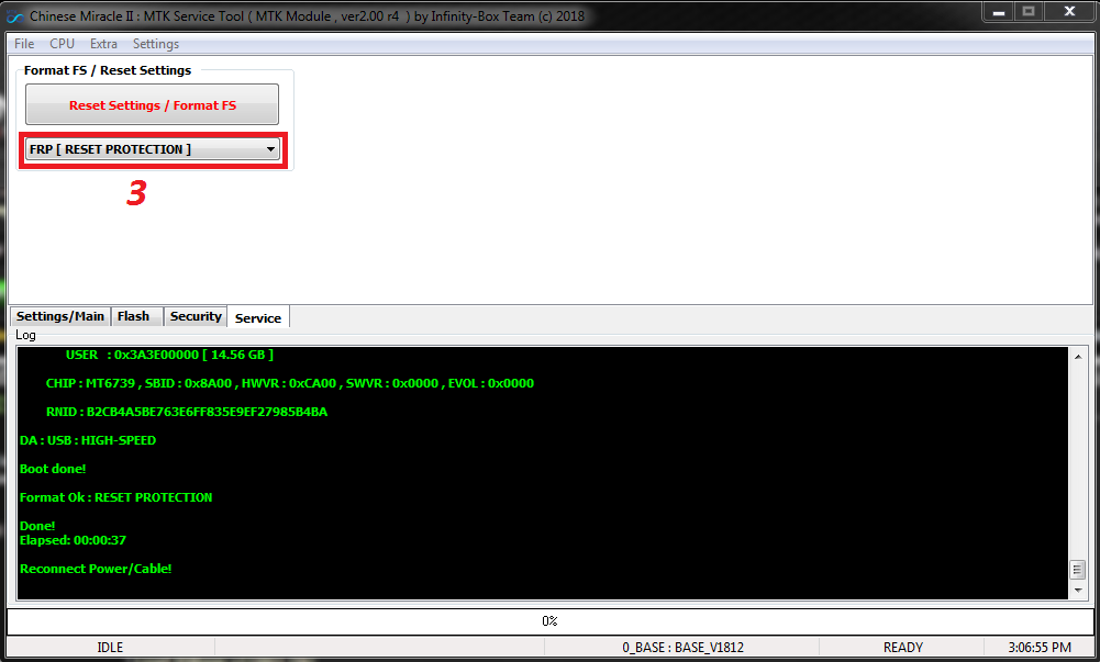

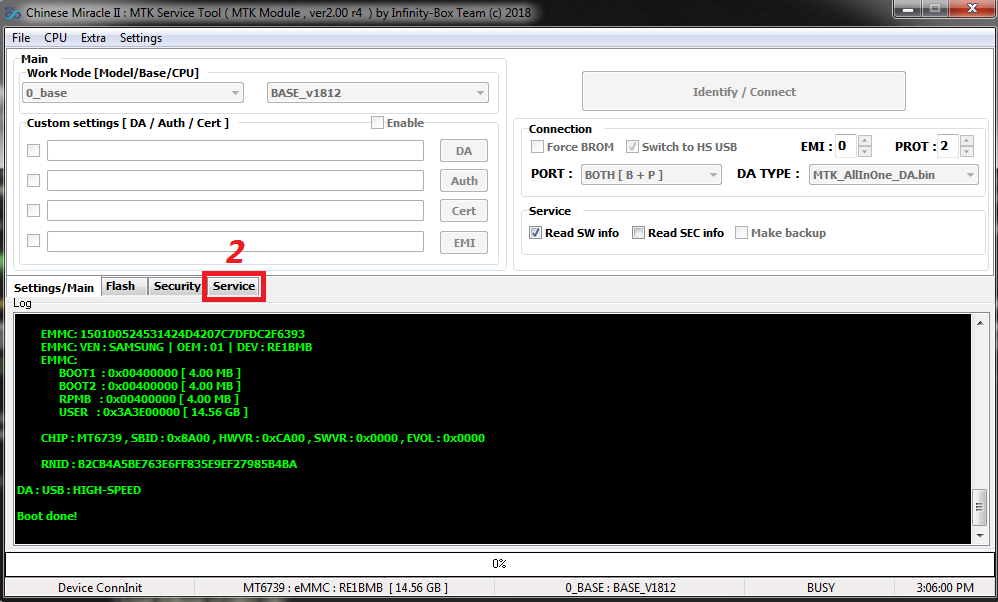

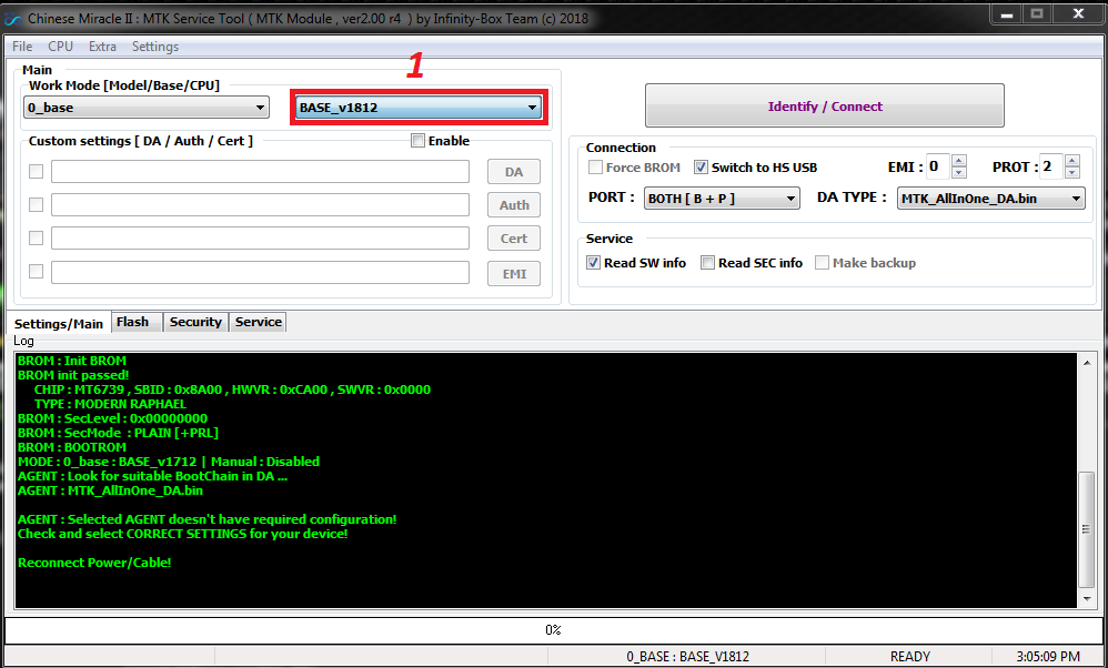

* Open CM2MT2 Select " Base V1812
* Click " Service"
* Then select "FRP [Reset Protection]"

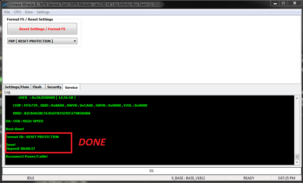

* Click "Reset Settings/Format FS" then insert usb cable.
https://falloutfacts.com/moira-brown-astronaut
* DONE

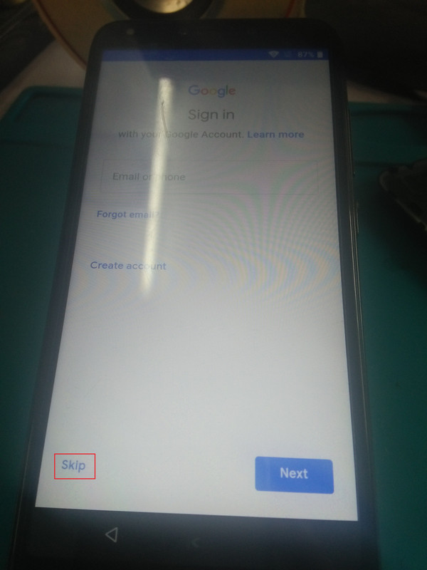

Naka reveal na ang "SKIP"

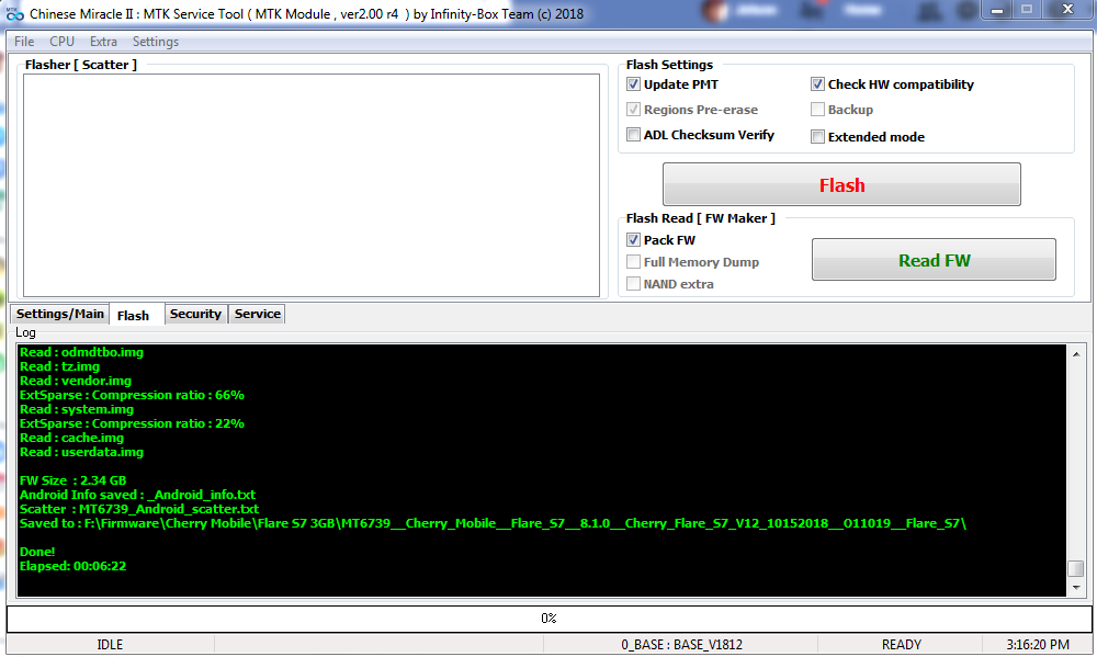

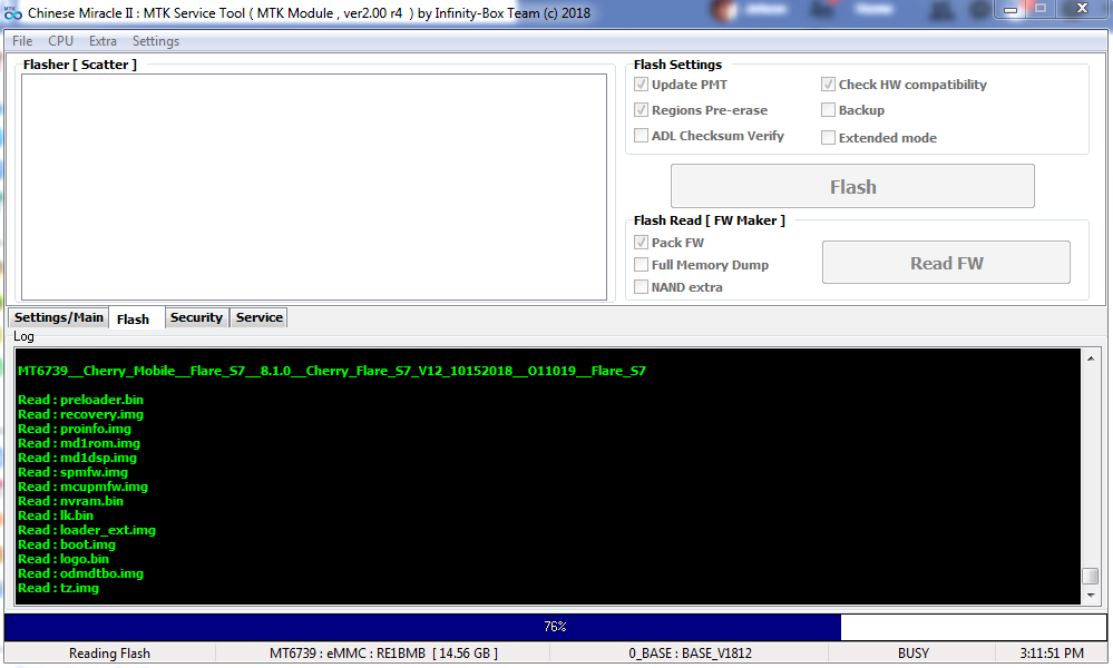

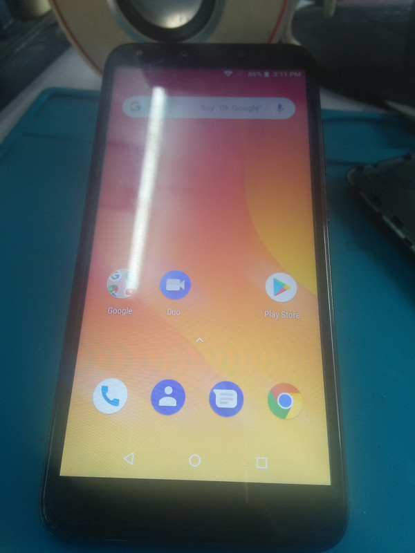

*Fresh BACKUP
CM2MT2 Backup: CLICK HERE
Password: ANTGSMSONNYFLARES7[3GB]
