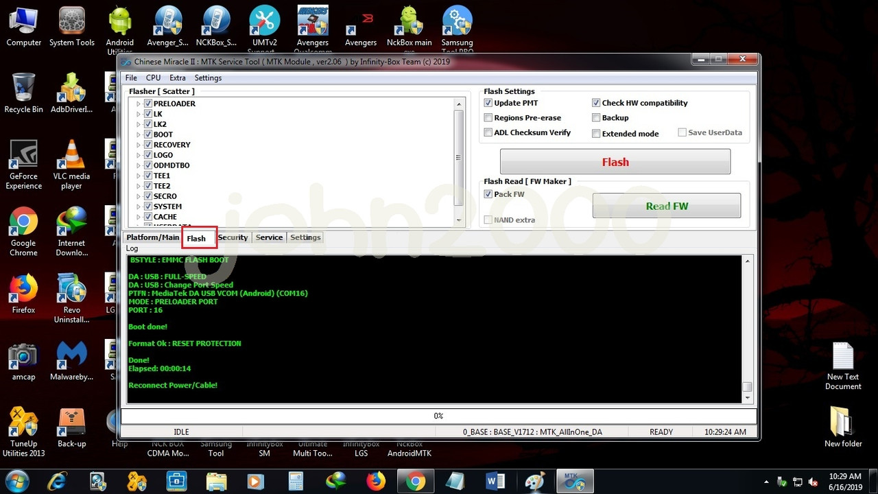

Run InfinityBox CM2MT2 GUI
Click Flash Tab
Load Scatter File [ need to Boot properly ]

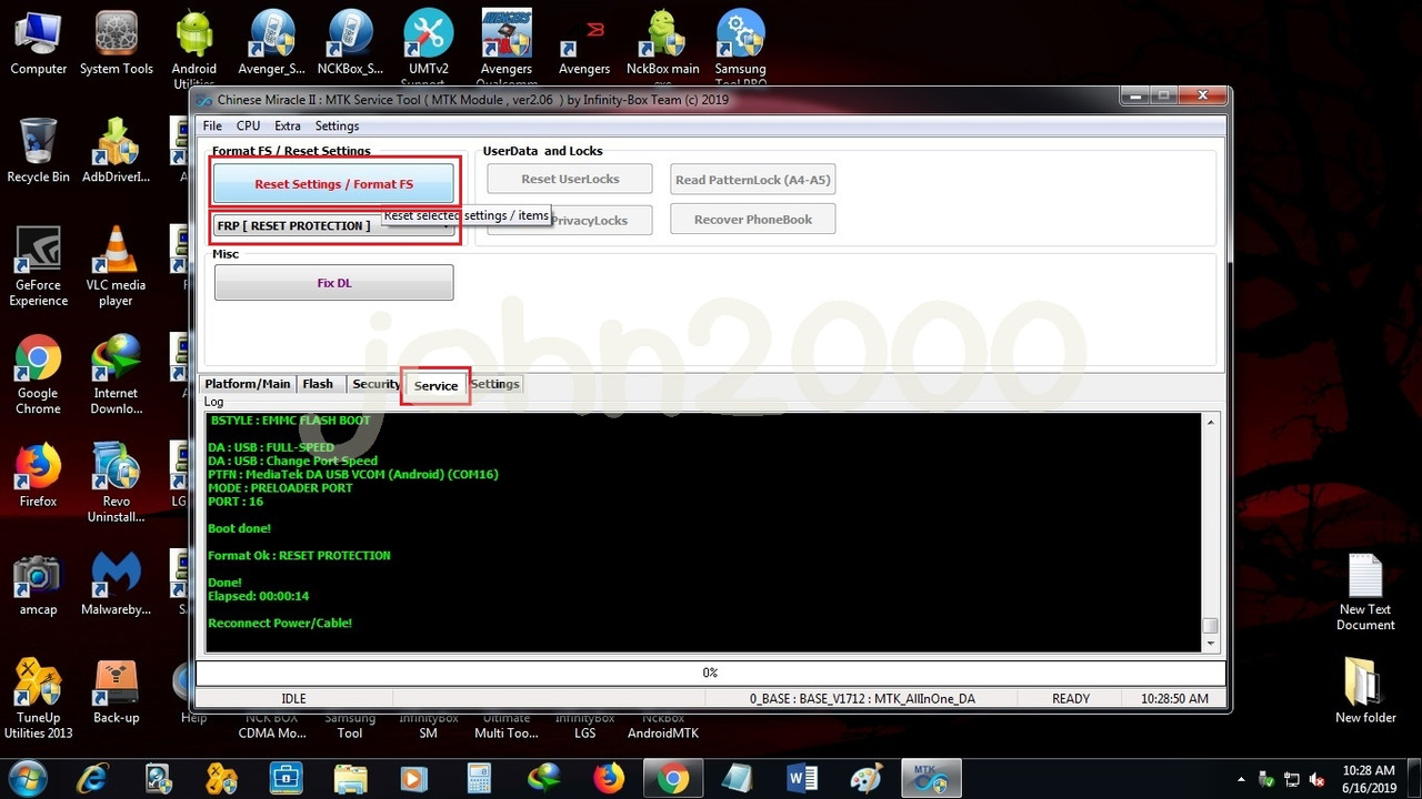

Click Service Tab
Select FRP [ RESET PROTECTION ] in Dropdown List
Hit Reset Settings/ Format FS Button
Power Off phone
Press and Hold Volume Down Button till operation done
Insert CA-101 Micro USB Cable
Wait till Format OK : Reset Protection Done

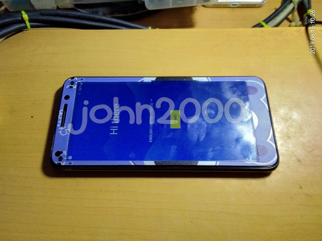

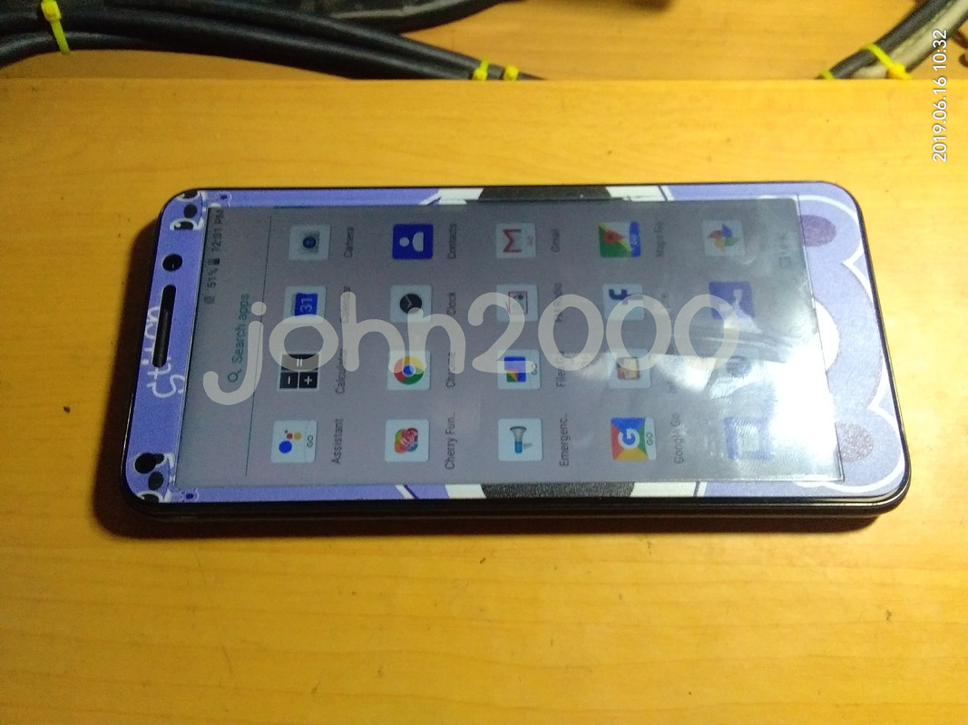

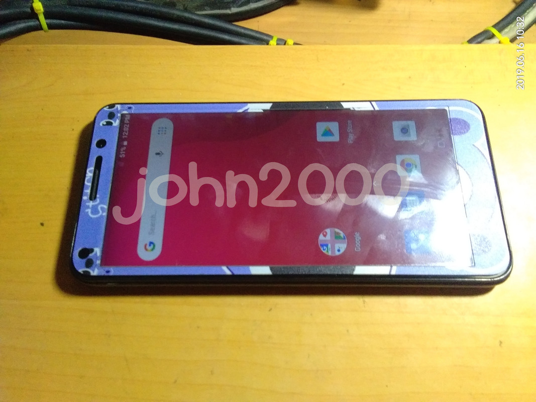

Result :
Done...
