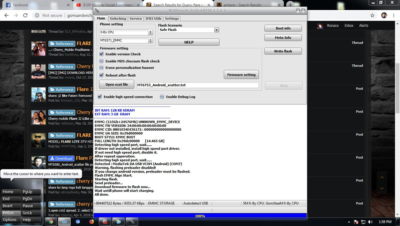

1, hanap firmware at ito nakita q https://mega.nz/#!4VgjzYjb!JIJII8LHr_1Lv5kflWDScOxnsgjGHuAWJIOWS3I065c
credits po sa orig na uploader ng firmware..
2, open Nck crack load firmware and flash

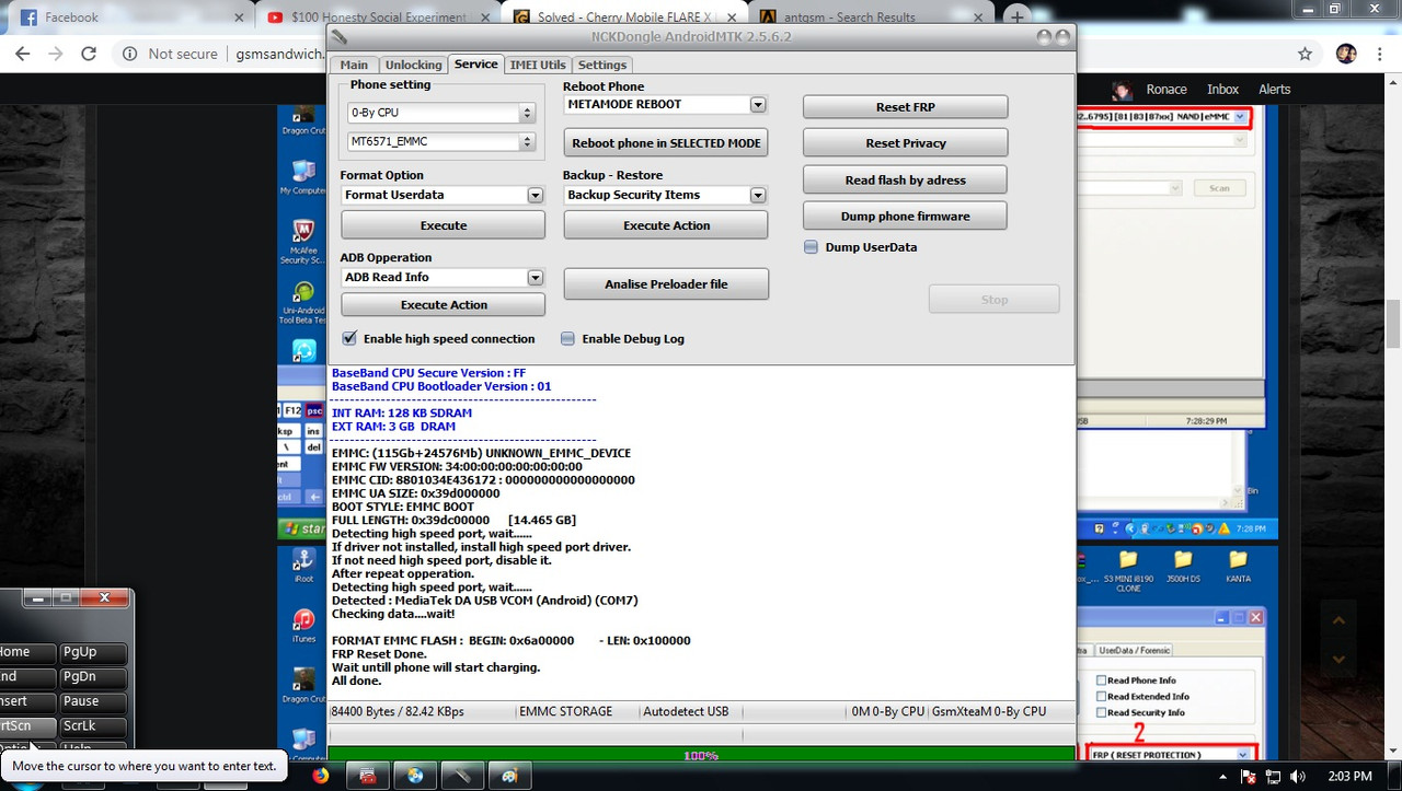

tapos power on ko nagtuloy na kaso may frp
kaya open ulit nck crack reset frp naman..

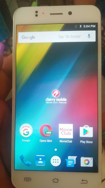

tapos power on ulit then ok na sya wala na frp..
sana po ay makatulong ito sa inyo..
screen capture freewaretapos power on ko nagtuloy na kaso may frp
