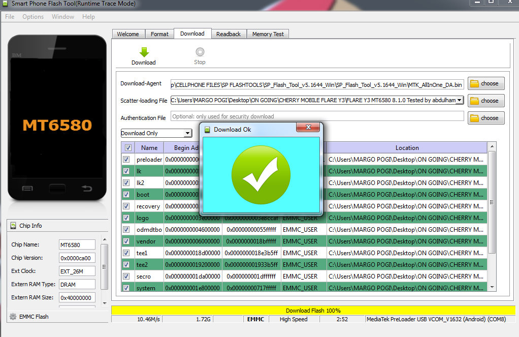

HANAP AGAD AKO FIRWAMRE DITO SA TAHANAN DI NAMAN AKO NABIGO PERO NAKAILANG FLASH AKO BAGO KO NAKITA YUNG NARARAPAT NA PARA SA KANYA
CREDITS TO OWNER THANKYOU
ETO YUNG LINK
http://www.mediafire.com/file/d9ad92jim89czdg/FLARE+Y3+MT6580+8.1.0+Tested+by+abdulhamid.rar
NO PASS TO MGA IDOL

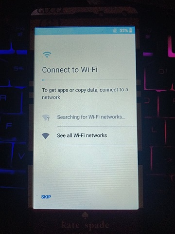

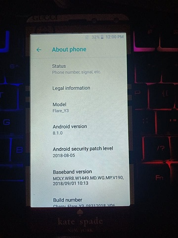

BAGO KO SYA FINLASH GAMIT YANG FIRMWARE NA YAN GUMAMIT MUNA AKO NG IBA YUN NGA NANGYARE NAG STUCK SA FASTBOOT
SO YAN NA GINAMIT KO
SUCESS

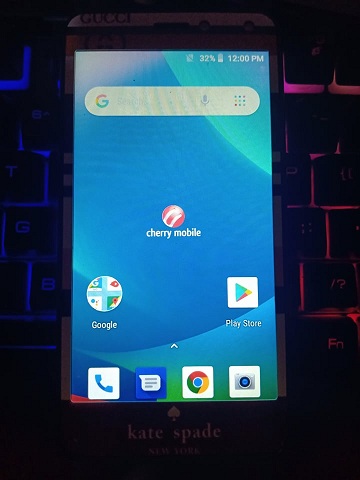

ETO NA KINALABASAN TANGGAL NA SI FASTBOOT
MABUTI NARIN AT WALANG FRP

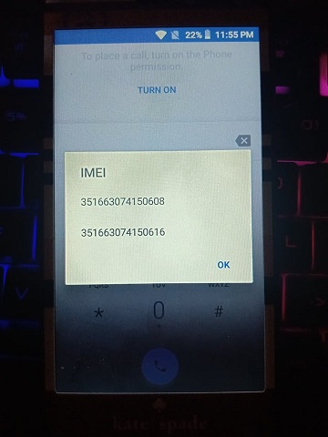

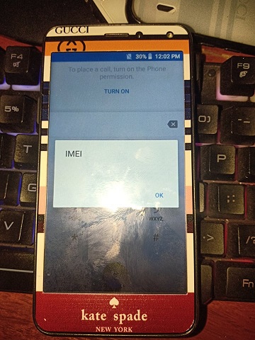

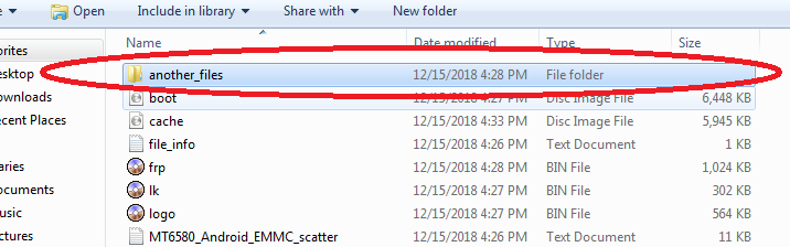

ANG PROBLEMA NAMAN IMEI BLANKO SYA

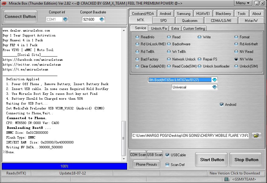

SO GAMIT AKO NG MIRACLE CRACK 2.82 PARA MA WRITE YUNG IMEI KASI HINDI SYA SUPPORTED NG ENGINEERING CODE
YUNG NVRAM NA GINAMIT KO NASA FILES NA DIN NA YAN ETO YUNG SCREENSHOT PARA DI NALANG DIN MALITO
CLICK ANOTHER FILES

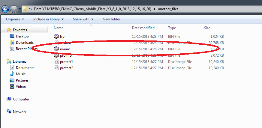

AND CLICK NVRAM
AND BOOM
OKAY NA SYA MGA BOSS SALAMAT TLAGA SA FILE NA YAN ANDYAN NA LAHAT =)
