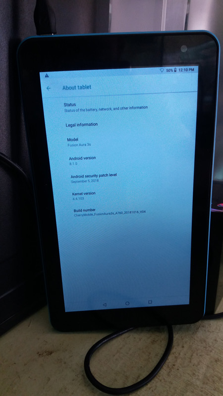

share ko lang mga boss cherry mobile fusion aura 3s frp lock done sa cm2 rkt module..
action taken..

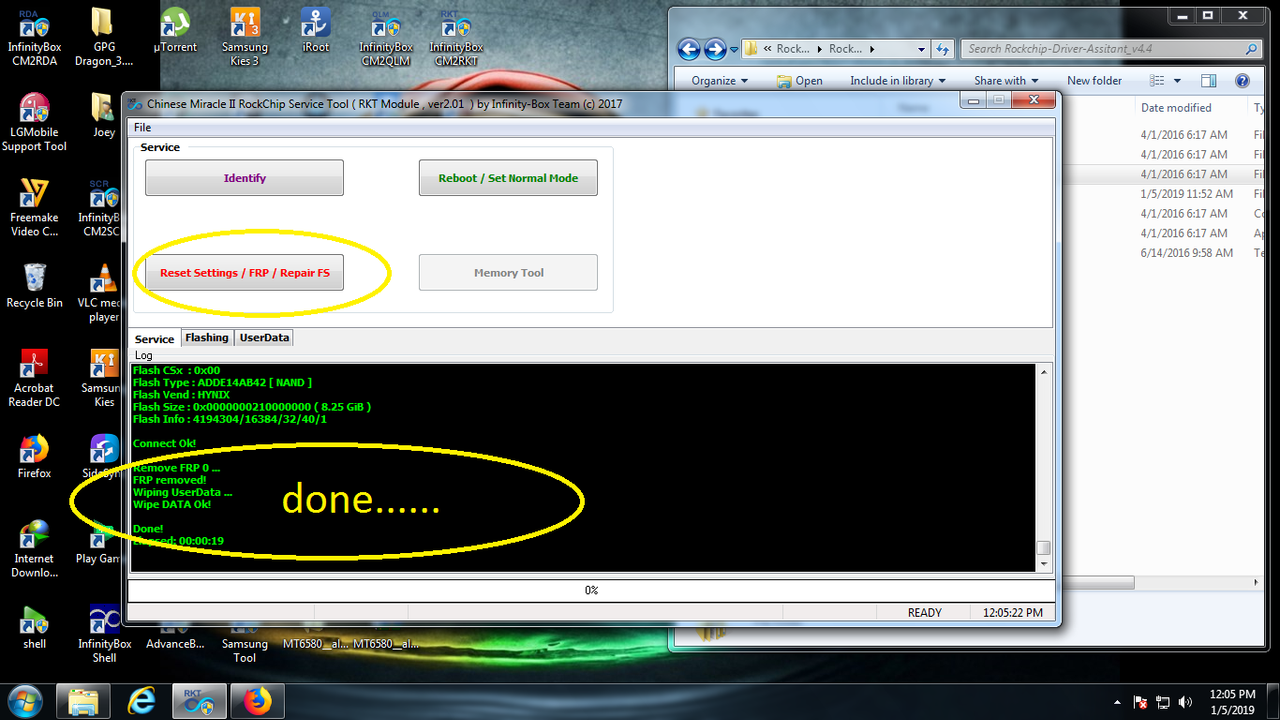

install rockchip drivers..in my case sa google po ako naghanap marami doon..
power off your phone
open cm2 rkt module
hit reset settings/frp/repair fs
para madetect yung tablet hol vol up
insert usb cable at pindut pindutin power button

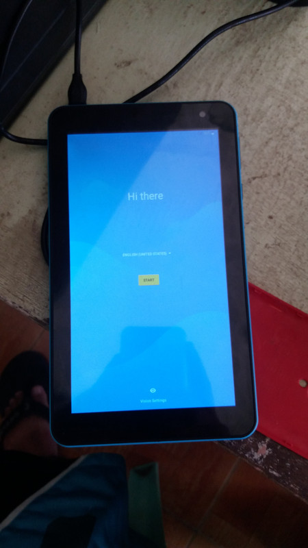

pics...
DONE..
