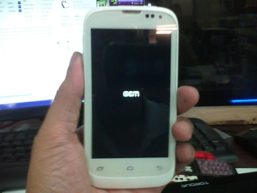

Cherry Mobile GEM hang-up tested firmware inside!

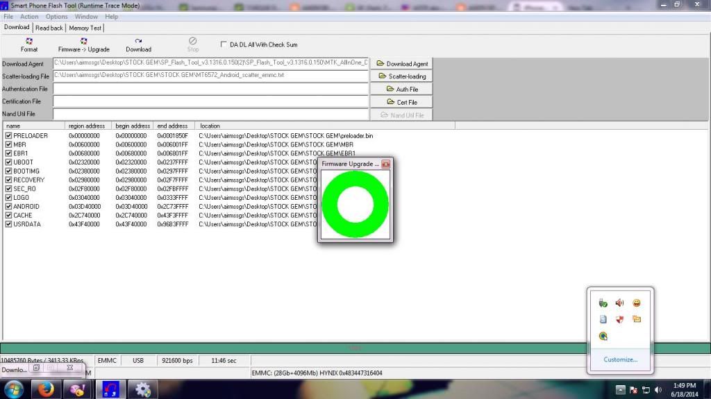

1. Extract the SP Flash Tool rar file to a
preferred location.
2. Extract and install Usb Vcom Auto
Installer Driver rar file.
Steps
1. Open SP flash Tools > Flash_tool.exe
2. Click on Scatter-loading
3. A navigation windows will appear
navigate to the extracted folder
4. Click on
'MT6572_Android_scatter_emmc.txt'
5. Make sure all are ticked automatically
6. Click on Firmware > Upgrade
7. Connect the phone while battery is still
out through USB and after 2-3 sec insert
the battery , wait until the process will start
8. Wait and done. (OK)

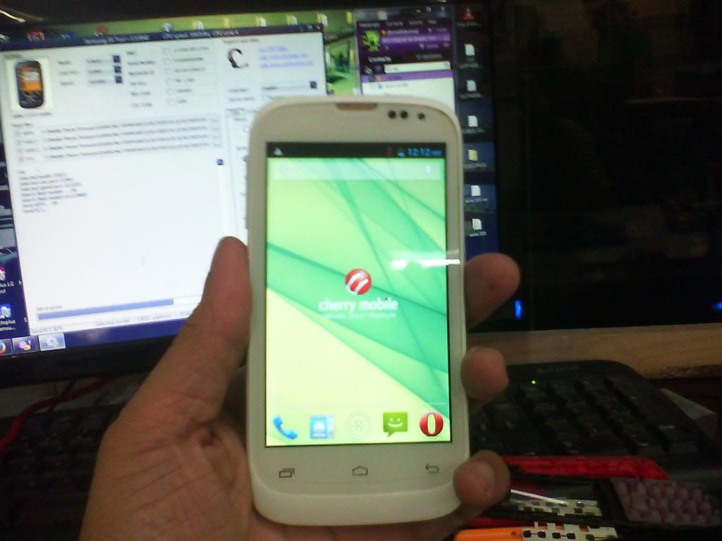

DONE:
tested mo naba to idol many times?
or just now? hehehe,,,!!!
BTW, congrats boss!
salamat po bossing,tested po skin.GOD BLESS PO..
