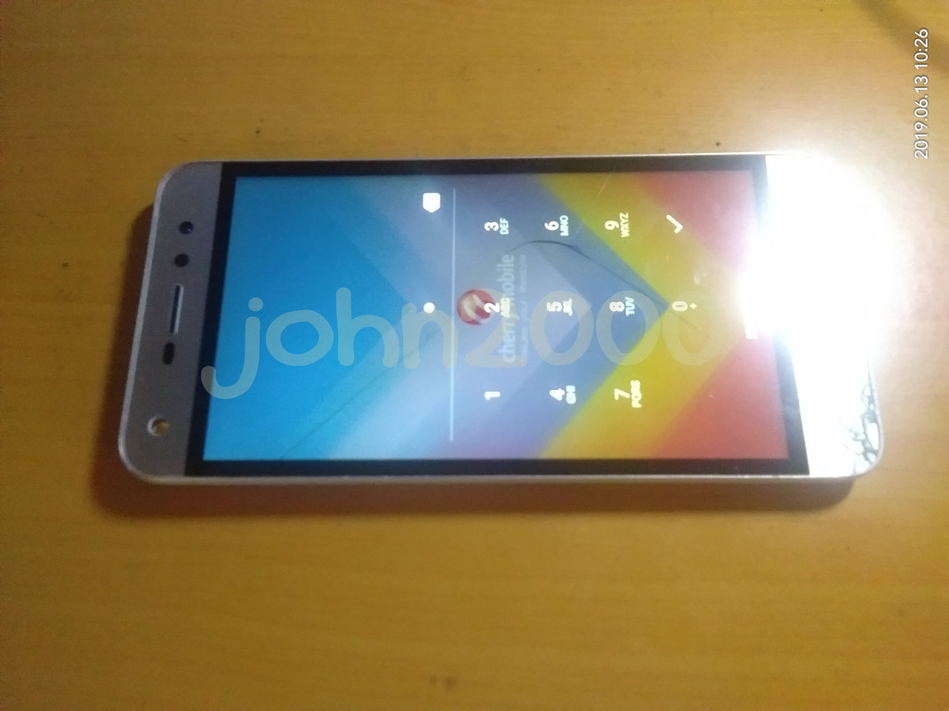

Action Taken :
Hard Reset not done
Solution :
Reset Privacy Lock

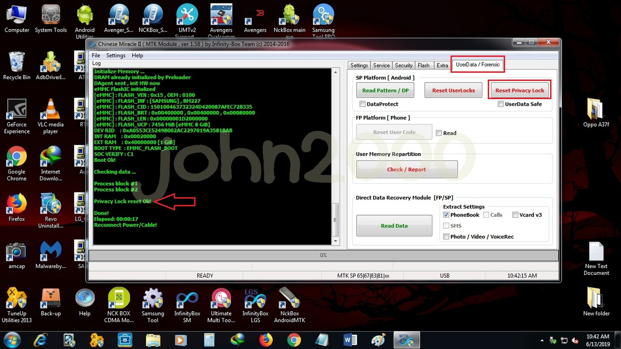

Procedures with Screenshots :
Run InfinityBox CM2MTK GUI
Select correct CPU/Platform/Workmode
Click UserData/Forensic Tab
Click Reset Privacy Lock Button
Power Off Phone
Insert CA-101 Micro USB Cable
Wait Privacy Reset Lock OK

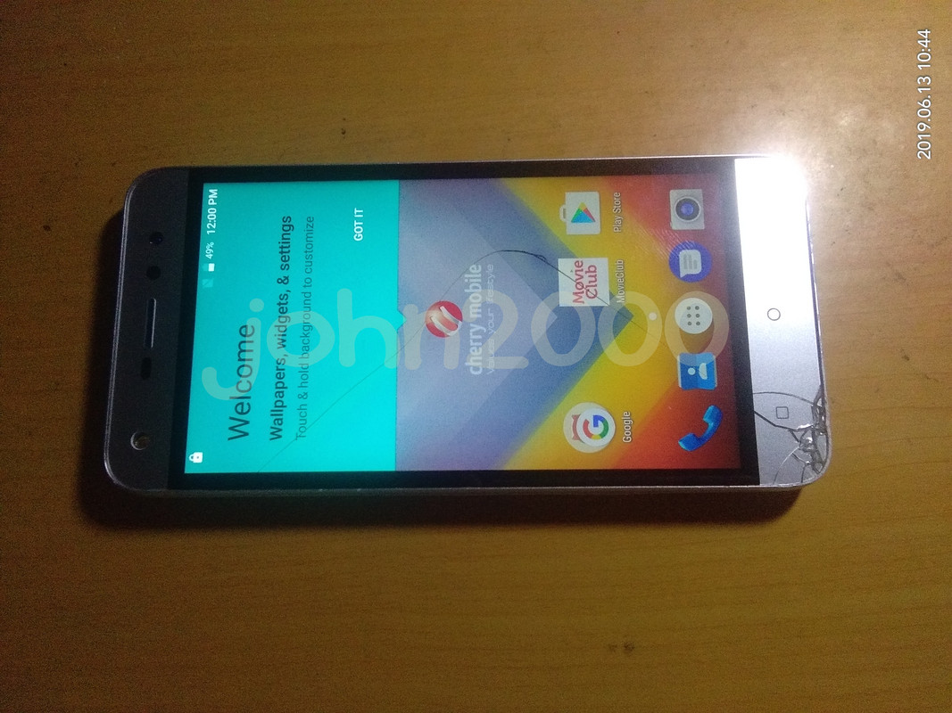

Result :
Done...
