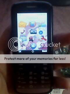

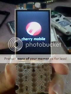

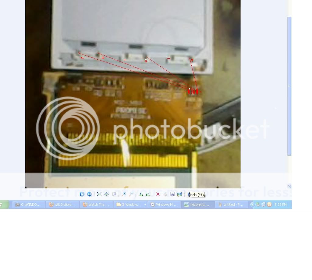

B BLIND Registered Joined Dec 23, 2014 Messages 2,965 Reaction score 14 Points 381 Location manila Feb 19, 2015 #1 Share ko lang mga boss cherry mobile M33 no lcd light. PROCEDURE eto po unit walang lcd light kaya try ko jumper like this. 100% ok pagkatapos ko jumper eto na unit ok na.. FINISH sana maka tulong..
