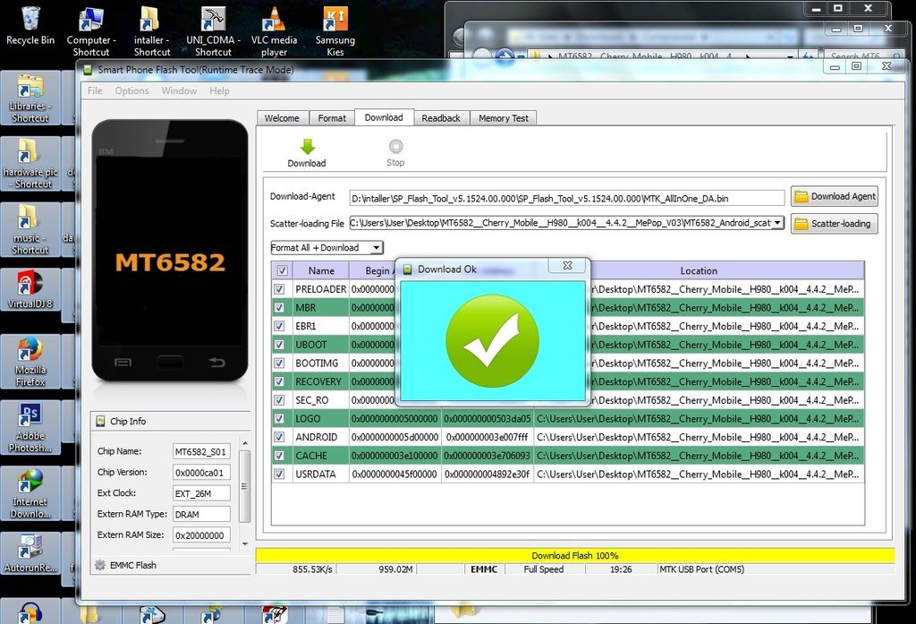

Mga K ANT baka po makatulong din pwede nyo ytr itong nagamit kung FW..
https://www.4shared.com/rar/hWCFMptfba/MT6582__Cherry_Mobile__H980__k.htm
history dami ko nang na try pro virus padin tapos yan nahanap ko...

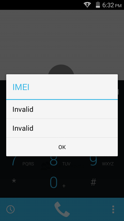

after flash invalid

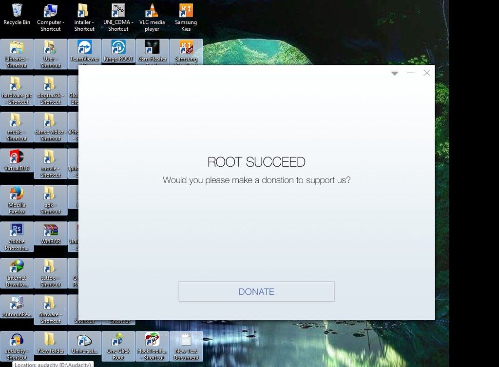

root ko po muna

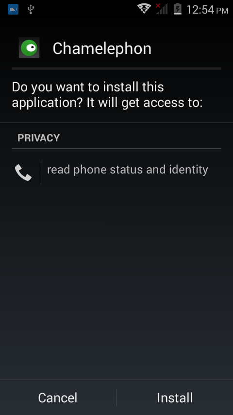

tapos chamelephon apk

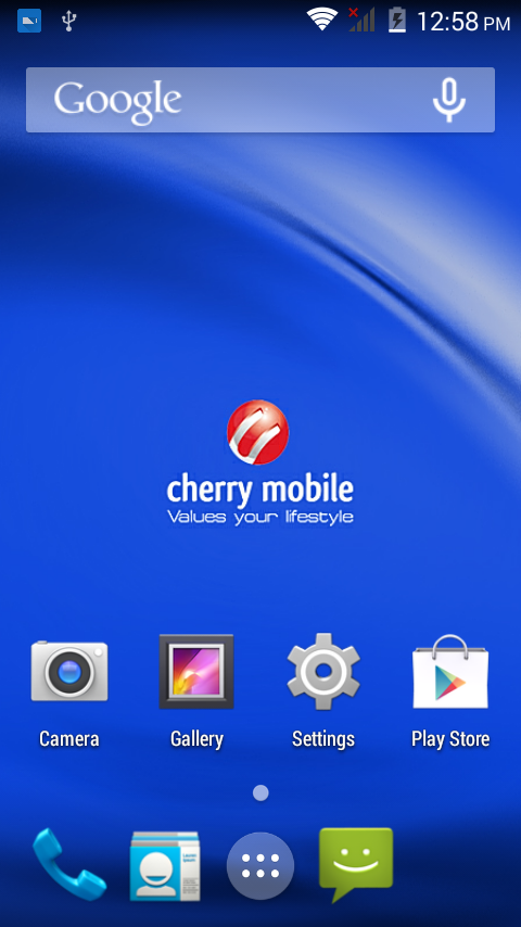

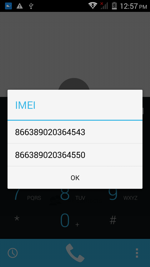

success
