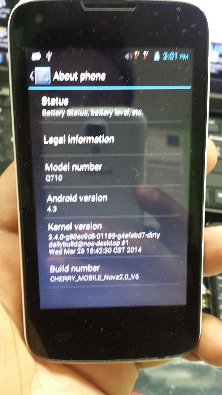

Model;cherrymobile NOVA 2 (Q710)
Problem; Apps unfortunately stopped

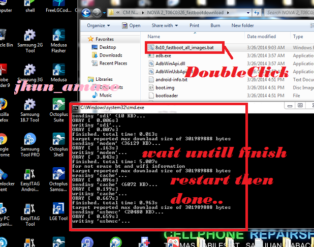

Action Taken; Flash via fastbootdownload (fastboot.bat)
FIRMWARE;
CLICK ME
pass; kulay rosas

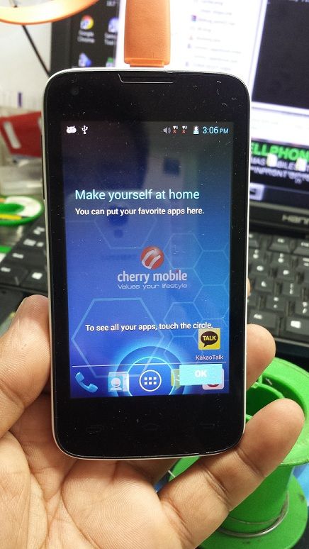

Download and extract the firmware,select and double click fastboot.bat connect phone wait until done..
After flash auto restart phone then done...:tgy
