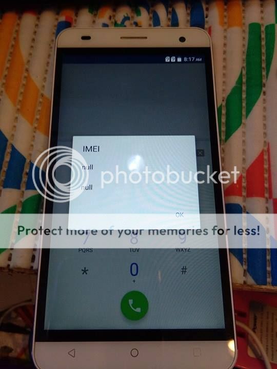

mga amo patulong po Cherry Mobile Omega HD3 NuLL

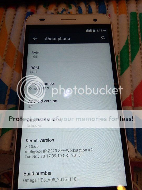

na program ko na po
Cherry Mobile Omega HD3_V08_20151110 Sprd7731_5.1 V1 By Team YuniX
SP7731GEA_HD_SP7731G_5.1_Cherry_Omega_HD_3_V08_20151110.pac
CM2 No Luck po
OK na mga bos new firmware talaga
V151_FNG_228_v151_fng_228_5.1_LMY47D_release-keys_Omega_HD_3
CM2SPD DUmp
Download Here
for fixing
unknown Baseband
Null imei
No Network service
use infinity CM2spd to write it
