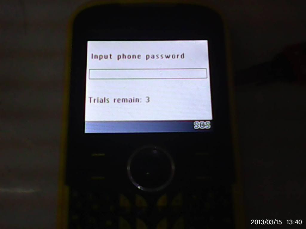

Cherry mobile Q9tv phone lock done by GPG 3.18A
Q9 TV cherry mobile Phone lock

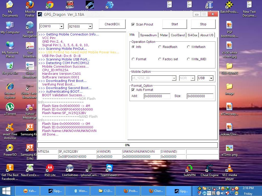

run GPG dragon v3.18A
select port if needed/cheack box
use usb pin out P-10C
select USB port
read info

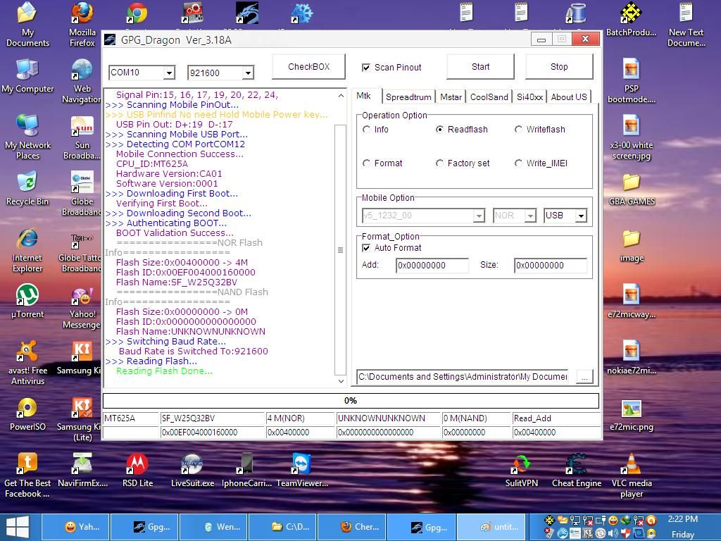

Read flash for backup

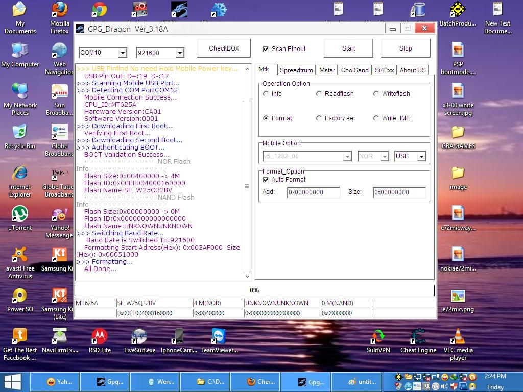

Format

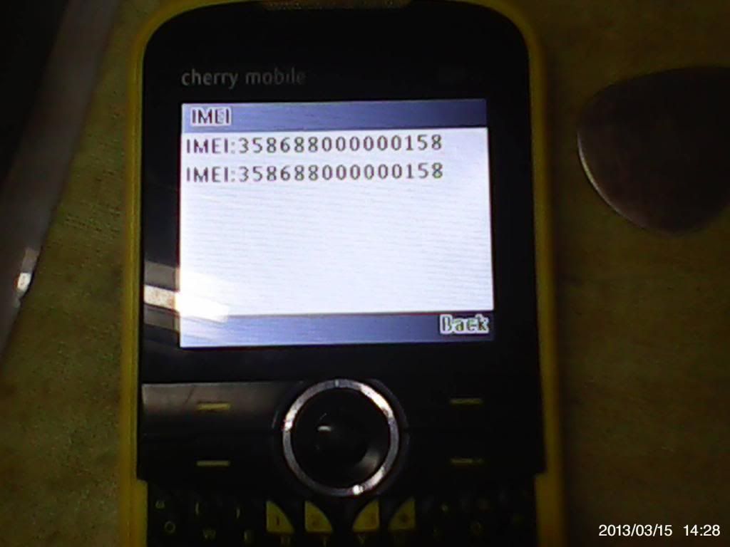

di na ako nag rebuild ng IMEI na gamit ang IMEI tool..
Finish
