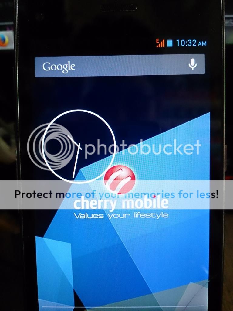

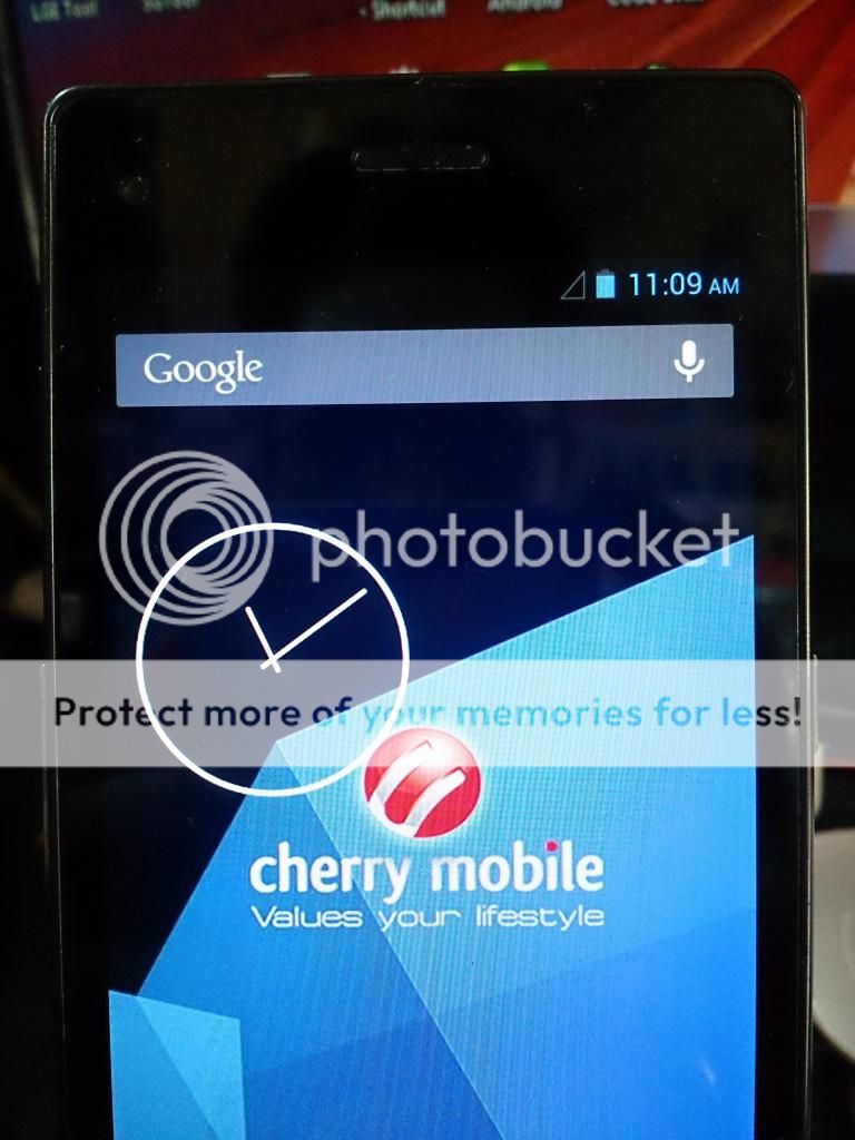

share ko lang po etong ginawa kong cherry,
walang bar sa signal pero nakaka emergency call.
.sabi ni tomer bigla nalang dw nawala ang signal
diretso ko na kay volcano...REBUILD IMEI

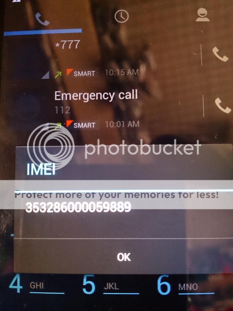

procedure:
open volcano box
android tool tab
usb mode
put check on rebuild imei
change the mode in mode3
put imei
make sure that phone's usb debbuging is open
click start
phone will reboot
and done..
