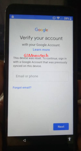

cherry mobile s7 prime 8.1.0 mt6580 frp fix by cm2mt2
pahabol ko lang sa lastday ng 2018 frp 8.1.0

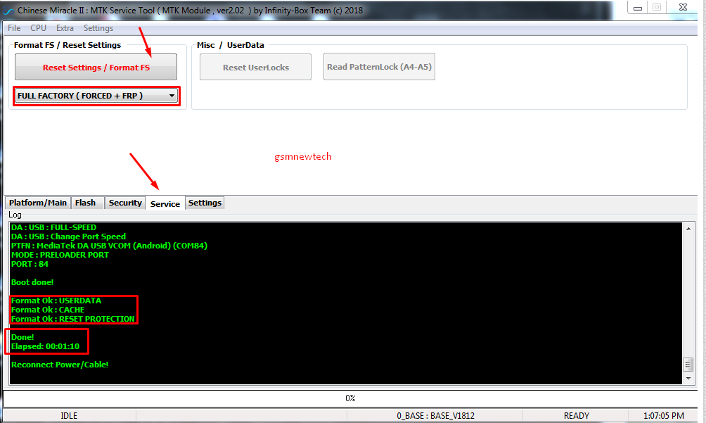

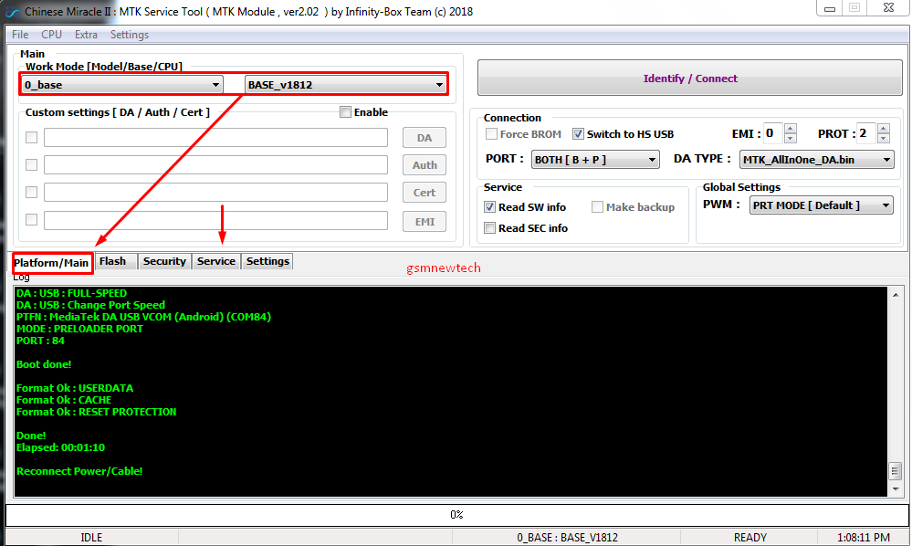

action taken open cm2mt2
paki chek nalang po sa pic.

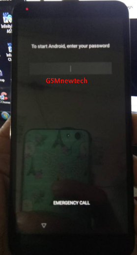

pagka format po nyan sa cm2 open nyo ng unit may lalabas
to start android enter your password ok lang po yan
off nyo ulit unit hold vol.up power button para ma hard resset

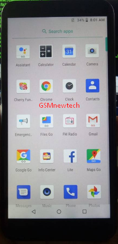

tapos ganito na pera na yan

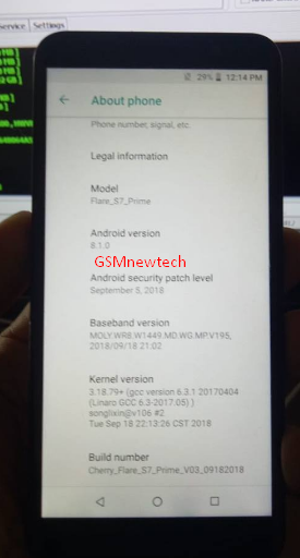

Patch Level : O11019
Display ID : Cherry_Flare_S7_Prime_V03_09182018
Ver. CodeName : REL
Ver. Release : 8.1.0
Sec. Patch : 2018-09-05
Build Time : 1537275809
Product Model : Flare_S7_Prime
Product Brand : Cherry_Mobile
Product Name : Flare_S7_Prime
Product Device : Flare_S7_Prime
Product Manfct : Cherry_Mobile
Product Info : we568b
Product Board : Flare_S7_Prime
Board Platform : mt6580
