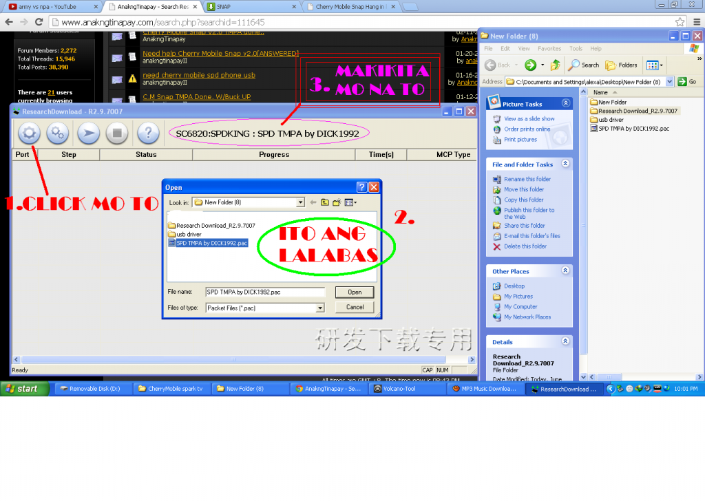

SA COMPUTER MUNA TAYO.. DOWNLOAD MO MUNA ITO
http://www.4shared.com/rar/Fg_EqoiBba/CHERRY_MOBILE_SNAP_security_lo.html
(package.. Research Download_R2.9.7007 - usb driver and SPD TMPA by DICK1992.pac)
after download.. extract lang po ang file

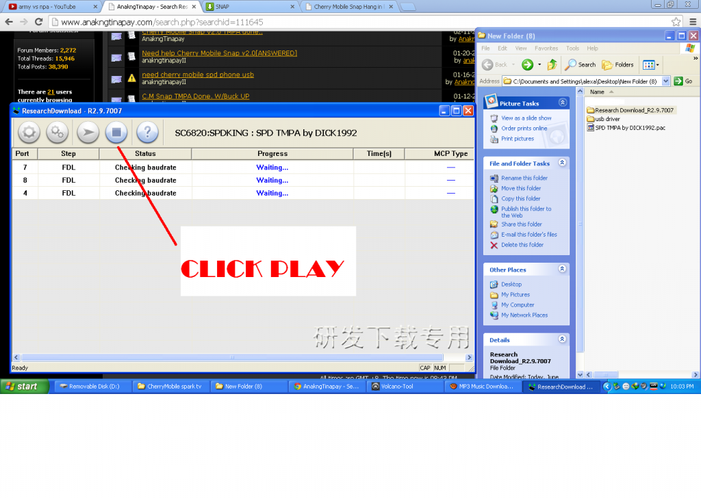

sundan lang ang larawan:

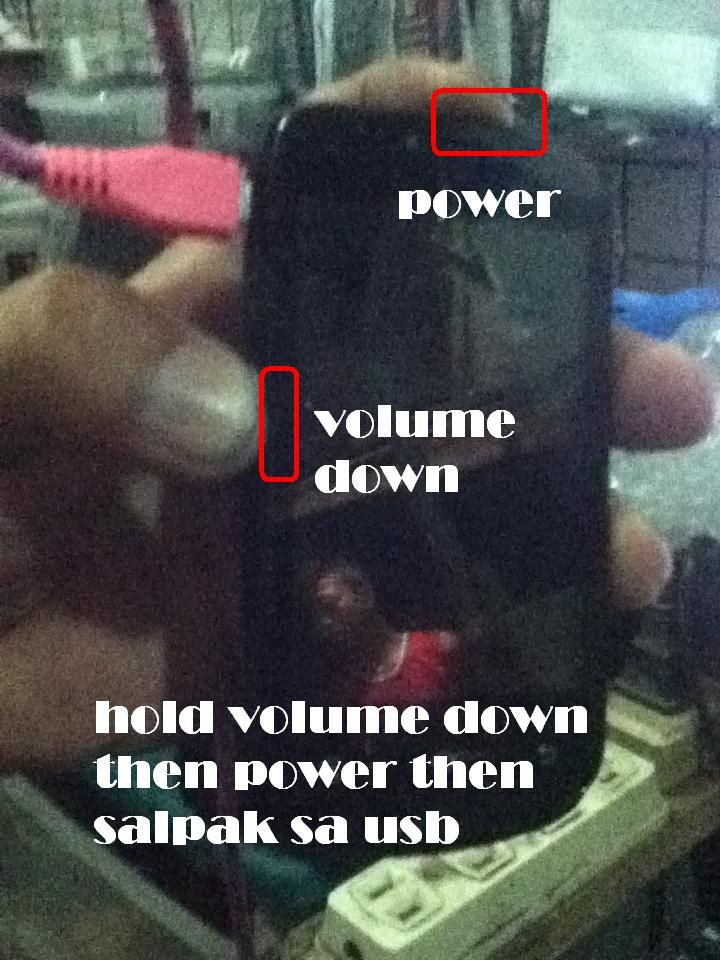

sa cellphone naman
hold volume down then power salpak kagad sa usb (CA-101)

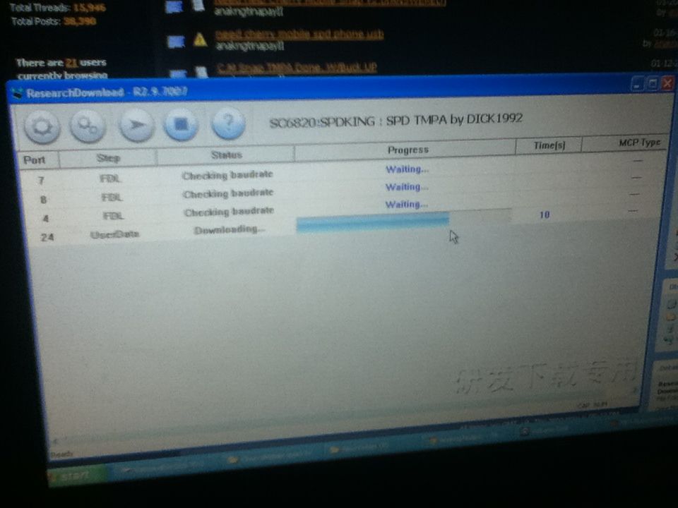

ito na ngaun yan.........:fishing:
hantay lang ng 12secs....
ok na po yan... may pambili na ng gatas...:8:8:8:8:8:8:8
