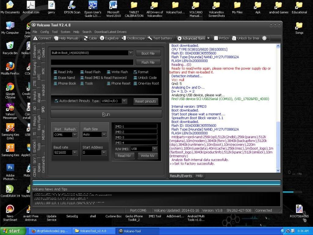

manila
procedure
open volcano 2.4.8
select spd
read info
read flash para sure po tayo
format
jigs P-05B
select built-in_Boot_14(6820/8810)
tick RUN and w8 Set to Factory successfully
