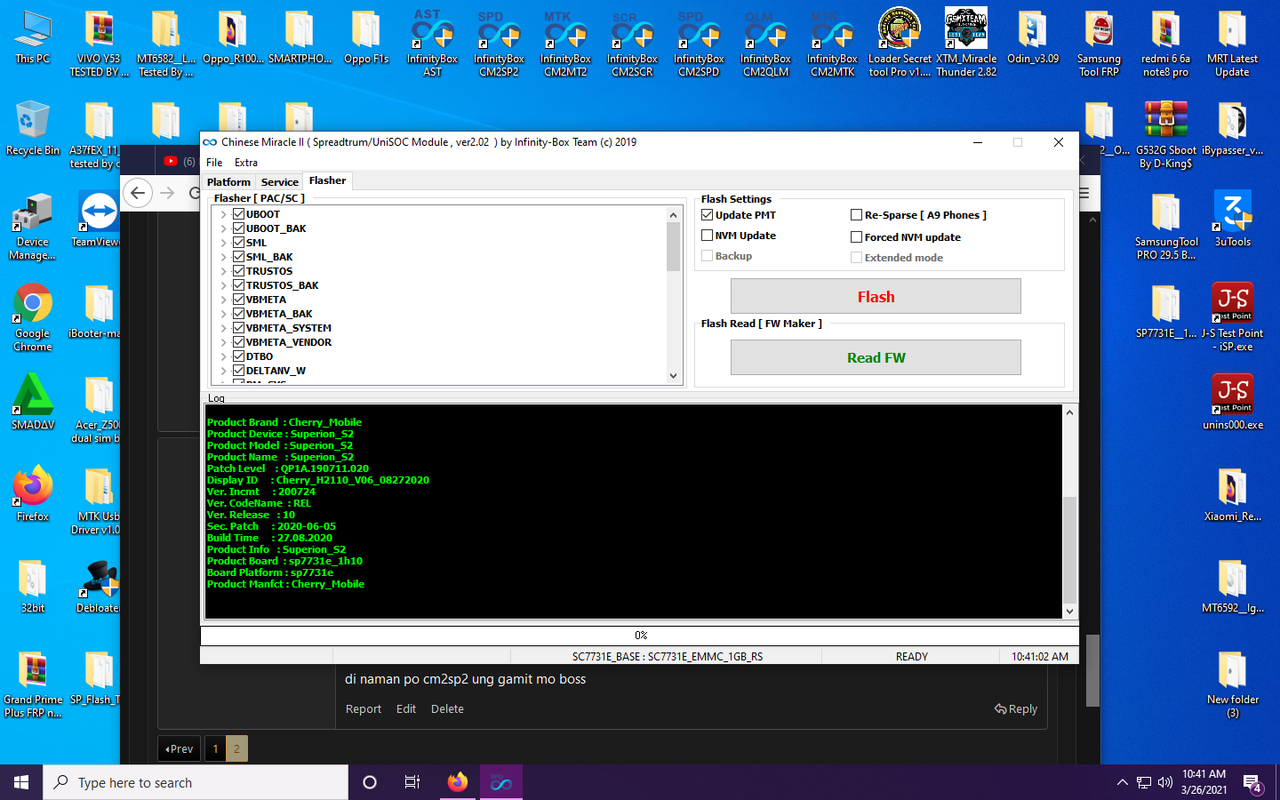

ang password ng firmware ay ewingsky
note: di ko po alam kung pwede sa superion s2 white ang firmware ko.....black po kasi yung sakin,,,kaya pang black lang po ang thread na to
back up nyo muna yung unit nyo sa cm2sp2 para safe,,do it your own risk po..
open cm2sp2
choose correct plaform sc7731e_base
load firmware
boot key is VOLUME DOWN
tested back up firmware >>>HERE<<<
maraming salamat po at naway makatulong sa mga naghahanap ng firmware ng unit na to.
firmware password ewingsky
open cm2sp2
load firmware
tested back up firmware https://www.mediafire.com/file/yadxcaqdbfnkqg4/cherry+mobile+superion+s2+black+by+killmore.rar/file
