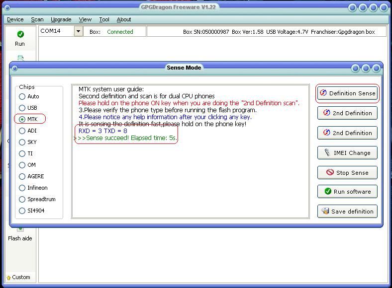

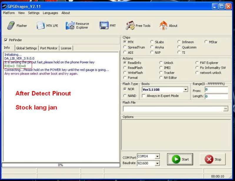

1st Step. Using Gpgdragon Detect ko phone para alisin ang lockcode ayaw tumuloy sa Booting Stock lang d2
After 15 mins of trying and trying No luck Stock talaga although Detect pero ayaw mag boot
Second Step. Use GPGDragon Freeware Tool Detect ko ang Pinout ok Detect na

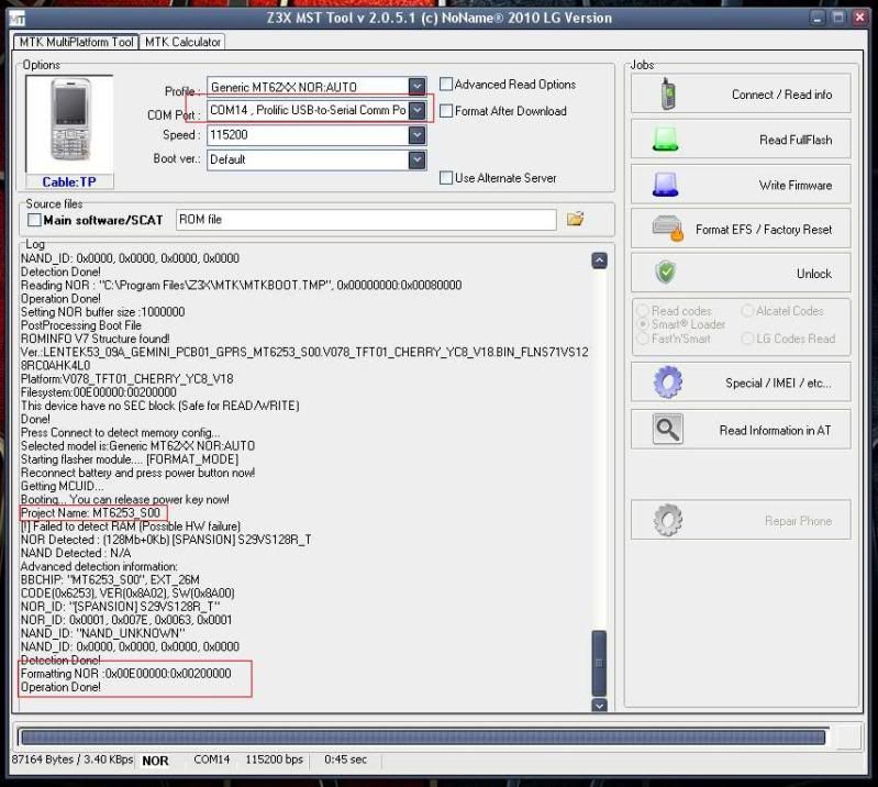

3rd Step. Using Z3x MTK Software use Gpgdragon as interface then Read Firmware, Use Auto Format Done no need to Change IMIE
hindi ko na kunan ng ScreenShot ang phone Pagog nako For Reference lang
Sablay Talaga sa MT6253 ang GPGDRAGON buti nalang may Z3x ako
