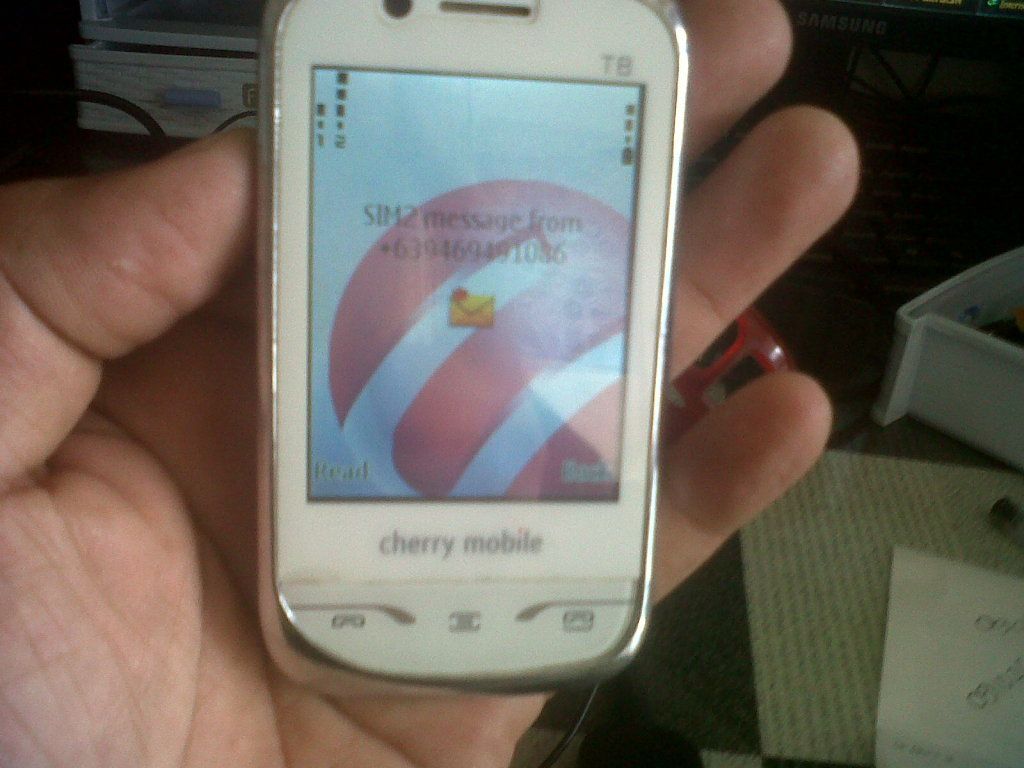

cherry mobile t8 unable to receive and send call and text [done][SOLVED]

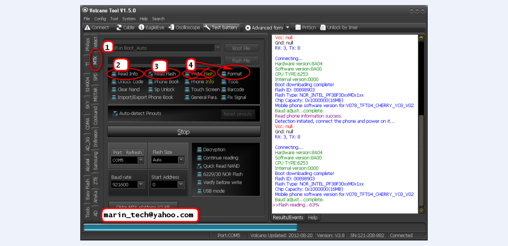

tools to be use: P-14H CHIP
and ofcourse volcano box

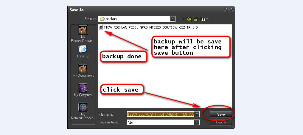

procedure: click MTK on tab
- then click read info

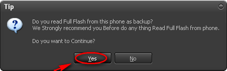

- click read flash to back up

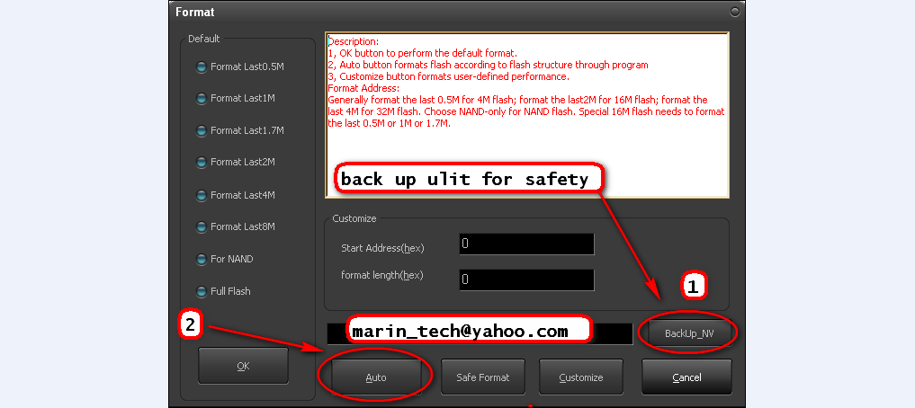

last click format
note hold power on after clicking read info,read flash and format
